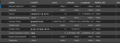

I've never experienced this, but my colleague reported something similar recently after trying to delete a field from the table view. The data in the field he tried to delete turned into wingdings and some of the other fields lost their data (values became nulls):
In this case, the table in question was the output of a buffer operation, if that makes a difference. It was stored in a file geodatabase on a Nasuni drive and the field he tried to delete was a text field without a domain.
