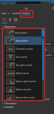

I have managed to get the labels to reappear by opening the Labeling tab and clicking one of the Label Placement options. I am still curious to learn why the labels disappear in the first place though, and why the solution made them reappear.

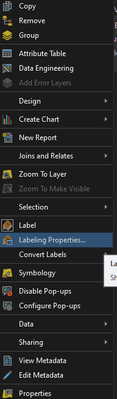

once you click on the feature class, choose label properties
then from the label class tap on the left side, choose (Position) tap, and select any one of the placement positions.
