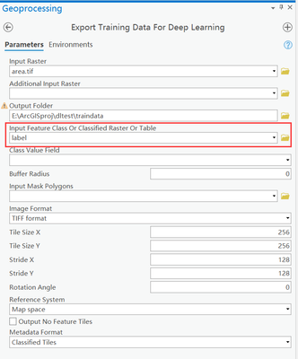

l mean for the parameter in the screenshot, feature class or classified raster, how could l choose?The help about this tool is not specific,there is no distinction as  how to choose.

sure,l have required inputs in both raster and vector. l make a test, when raster as input, it could only export  data with classified tiles format.
