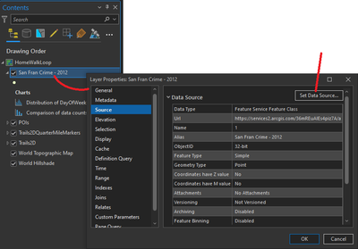

Thanks for the suggestion - can you share a link on how to "Reset the data source" for a layer?
NathanShephard
Sure. It's on the 'Source' tab of the Layer Properties dialog.
