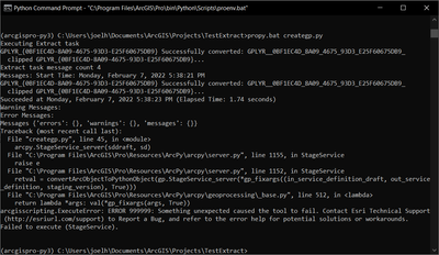

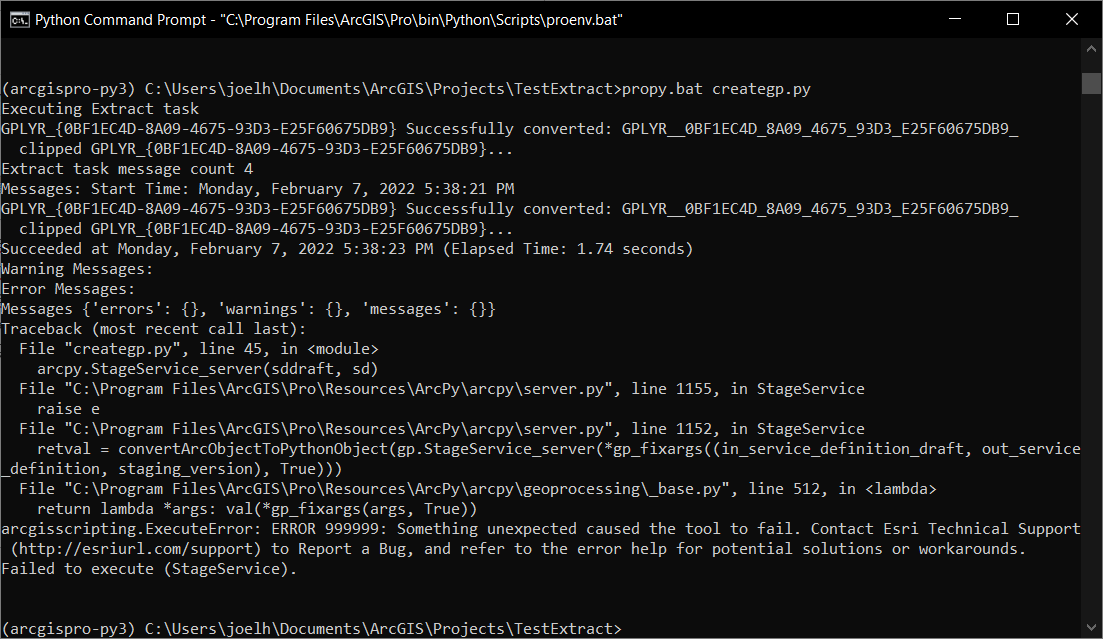

I'm trying to automate publishing the ExtractData task as Geoprocessing Service. To do this, I created a small Python Script which executes the ExtractData Tool and then it should publish the result object as a Geoproccesing Service. The input to the script comes from an ArcGIS Pro Project, I tried it with a layer from my Enterprise Geodatabase and with a layer from the default project file geodatabase. Everytime I run the script from the commandline, it fails with the Error 999999, however, when I run the script from the python console within ArcGIS Pro, it runs fine.

Any ideas why this script fails on the command line?

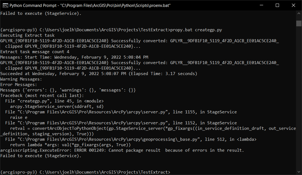

Still no luck:
It's now telling me there's an error somewhere, but I print both the messages from the Extract Task and from the staging and there isn't an error before it fails (or I need glasses, because I don't see it anymore)
