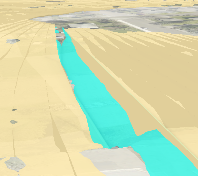

Here are the polygons I am having issues with.
Its hard to see but this image is the transition from straight edges to Curved:
The elevation between the two are only a few inches but are extruded differently.

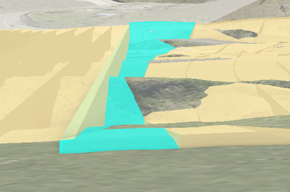

Here is another transition between Curved and straight edges:

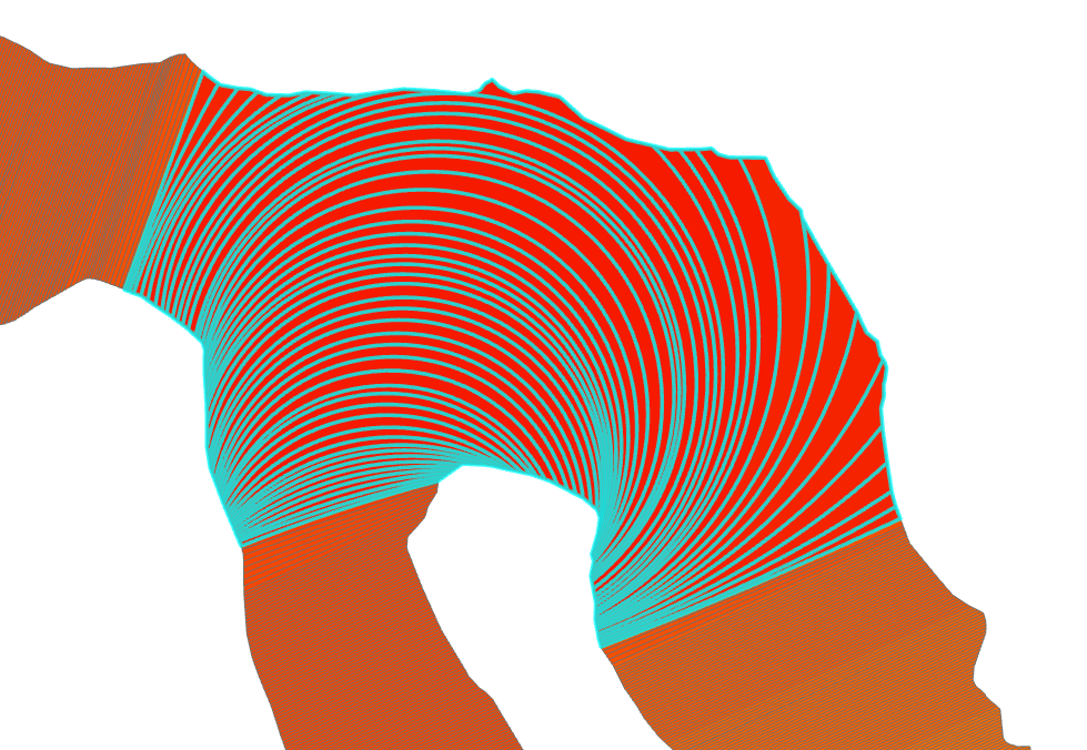

I just tried running simplify polygons. Here is the result after extruding. Its like this section is not extruded.
DanPatterson_Retired
MVP Emeritus
looks like simplify oversimplifies
