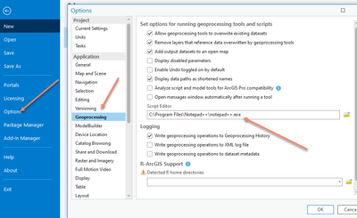

I have set up PyScripter as my IDE for editing tool scripts and Python toolboxes.  It works great:  no problems with the virtual environment.  The issue I run into is that, when I choose Edit ... from the right-click menu for a Python toolbox or a script tool in the Catalog Pane, the toolbox/script tool is opened for editing simultaneously in both PyScripter (in same PyScripter instance, if already open, which is how it should be) and Notepad.  Edits are possible and saveable in both windows.  I want the scripts to open only in PyScripter.  Is there a setting I am missing somewhere?  Is this a PyScripter problem (I can't see how) or an ArcGIS Pro problem?  I cannot upgrade PyScripter at this time, because I still need the Python 2.7 functionality for managing legacy scripts.  Also, I cannot upgrade to ArcGIS Pro 3.x, as I have active projects using Python.NET, and the pythonnet module does not (yet) officially support .NET 6.  (pythonnet alpha dev adds .NET 6 support, but I am not allowed to use that version for my work.)

Don't have PyScripter installed, but if I set Notepad ++ as my pro script editor, it will only open in Notepad ++ when I right click and select edit.

@RhettZufelt -- Rats.  Sounds like a PyScripter problem after all ........ indeed, if I switch over to Notepad++ as the editor in ArcGIS Pro, only Notepad++ is opened when I edit a Python toolbox.  Rats again.
Anyone know a solution for this?  I could get by with Notepad++--one of the best text editors out there--I use it every day--but I have gotten rather attached to PyScripter.  It works just the way I like it, and has the value added IDE functionality that I find useful and nothing much more.
