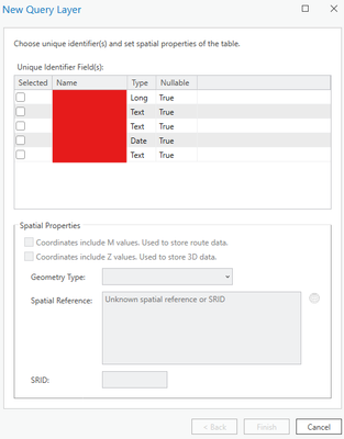

I have two mirroring deployments (Dev & Prod) of postgres with postgis extsnsion (i.e. not esri enterprise geodatabase) on AWS rd servers . The database on Prod was accidently deleted and then restored from old backup files each taken for individual schemas. Now, when I drag the database tables as query layers to ArcGIS Pro, it doesn't recognise the spatial properties despite having geom column. Instead it gets added to TOC as standalone table:

I had a similar issue happen with some layers in my organization's PostgreSQL+PostGIS database. Make sure your layers have a spatial index assigned to their geom.
QGIS, which is what we use internally, auto-assigns a primary ID and spatial index. However, when testing our partner agency connections through ArcGIS Pro, I ran into the same prompt as your screenshot. Turns out some of our database layers did not have a primary key set, nor a spatial index on their geom. Once I ran the SQL commands to assign these, the issue was resolved. This also lessened the loading time for a layer in arc pro.
