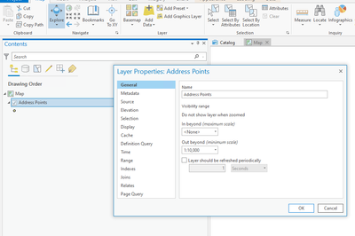

It may be that the visible scale is already set for the given layer and you aren't zoomed in enough to see any features. Take a look at the image below:

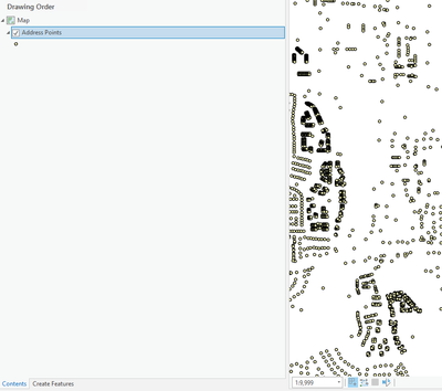

Notice in the table of contents the visibility check mark is grayed out for the layer Address Points.  Notice too that when I right click on Address Points and select properties, the properties window shows that I won't see any features until I am less than 1:10,000.  When I zoom to the extent of Address Points, I my map scale is at 1:275,623:
I can manually set that scale to 9,999 and everything switches 'on'....
