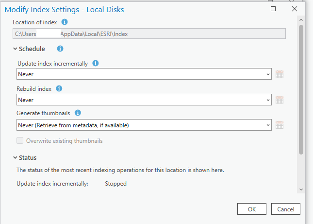

davidcsuha
Try turning off indexing.  In my experience, this started happening after I was working with tiff files.
