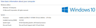

Hi @ChrisUnderwood, I was using it before and it was working fine on this system. It was version 3 something. I uninstalled it and installed 2.9 but it has the same issue. When I login with my institutional credentials, the window just disappears without any trace.
System details:
