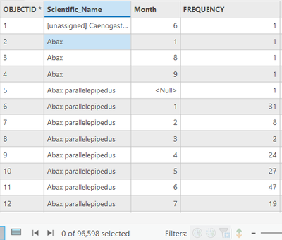

I am using ArcGIS Pro I have a table full of wildlife sightings, containing, besides many other fields, the scientific name of the species and the month the sighting was made in, as an integer from 1 to 12. I would like to create a new field showing the month the species is most frequently sighted in, i.e. the mode of the month field.
My first thought was to use Summary Statistics, with Month as the Summary Field, Mode as the Statistic Type and Scientific Name as the Case Field. But there is no Mode option on the Summary statistics tool.
I then tried running a Frequency tool with both Scientific Name and Month as frequency fields. I thought I could then select the entries with the maximum FREQUENCY from that, but can't figure out how to make the SQL query work. That frequency table looks like this:
Any help would be much appreciated, either to just directly calculate the mode of a field in some way, or any kind of workaround!
Thanks!

DanPatterson
MVP Esteemed Contributor
Emulate this script in
Solved: Calculating the Mode from list of fields using fie... - Esri Community
just use a single field in the expression.
Or if you need a broader statistics summary, including the mode, see
Field Statistics To Table (Data Management)—ArcGIS Pro | Documentation

YusefSamari
Many thanks Dan. I went for the Field Statistics to Table option, good to know about that!
