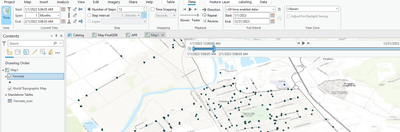

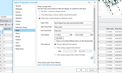

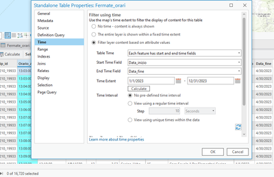

in an ArcGIS PRO project I set up two Layers (Feature Layer and Standalone Table) with two start and end date fields.
I then used Enabled Time to filter the layers by date.
I noticed that the Feature Layer is filtered correctly while the Standalone Table is not.
Is there something I am doing wrong or is there a bug in ArcGIS PRO?
I attach two images with the settings of the Standalone Table and the result of the filtering (or rather the non-filtering).

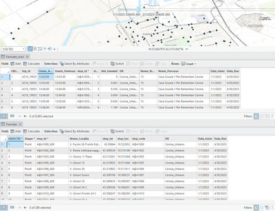

Using sample data, set up ArcGIS Pro 3.1.2 map as follows:
Layer - Record Count 573
Table - Record Count 16720
Date Span of data 1/1/2023 - 12/31/2023
Set Time Slider settings as:
Have the time slider show data including January 2023 shows:
Layer - Record Count 288 of 573
Table - Record Count 9885 of 16720

Moreover, the Data_Inizio and Data_Fine (Start and Finish Date) fields were created and calculated the same way for both the Layer and the Standalone Table (see the attached image).
However, ArcGIS Pro keeps filtering the Layer data and not filtering the Standalone Table data.
 Hope this helps!

PaoloBasile_ST
Yes you are right!
If I create a new ArcGIS Pro project it works without problems, if I use it on the working project map I have problems (I don't know why).
But this is not a hindrance and at this point we are able to move forward.

AlyciaRajendran_esri
Have you turned on filtering for the table? I can't see the status bar of the table (bottom) in your picture, but there should be toggles here for time, range, and extent:
Is the time toggle on?
