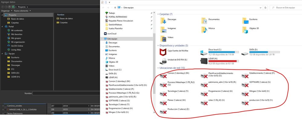

Hello, thank you for everything and everyone.
The version I am using is 2.7.1.
In the beginning it worked well, but in some version change this problem started. Sometimes I think it takes because I have many network drives disconnected and it takes time to read, but I don't have these network drives associated with my "Arcgis Pro" either,
I also think that it is a problem of the browser you use, because as I mentioned in another post, the same thing happens with Drone2Map, which uses the same browser.
It only happens when I open the project the first time, as long as I have it open I can continue using it without problem, if I close and open it again I have to wait.
If I want to access Arcgis online or if I want to upload a file, I have to wait.
I have tried all the recommendations, removing cache, renaming the cache folders, doing a clean install and on and on.
