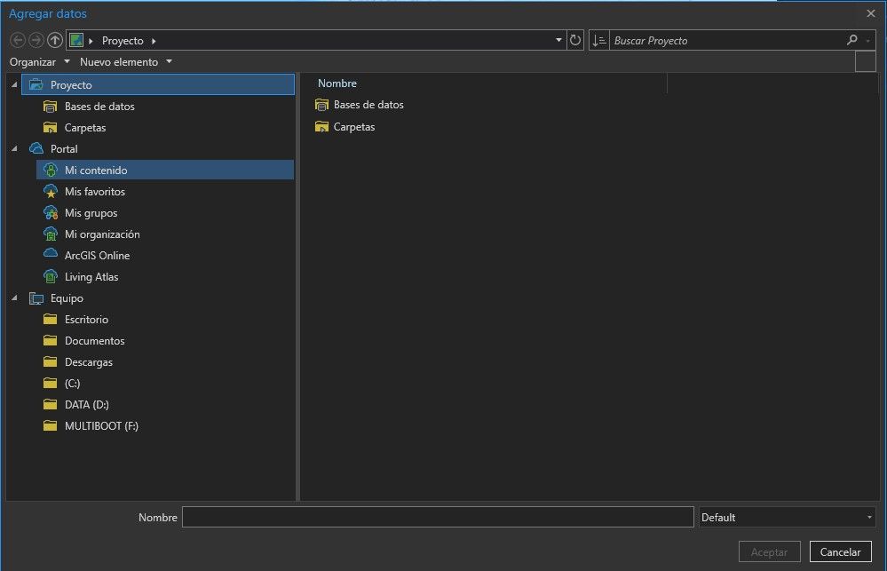

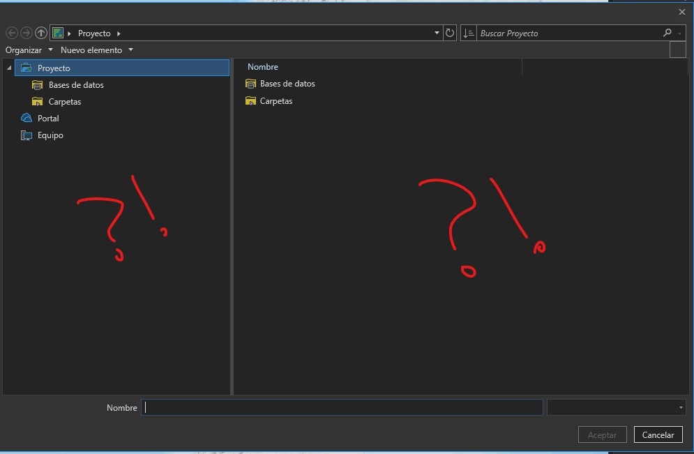

I open Arcgis Pro, I create a new map, I press the button to insert elements to the map, it opens to the browser window and I cannot access my data until it finishes loading the folders, this takes about 10-15 minutes to refresh, I try to paste the path in the browser and it takes me directly to the folder but I can't select any item inside. I have to wait an "eternity" for the rest of the units to load, and to be able to work ..

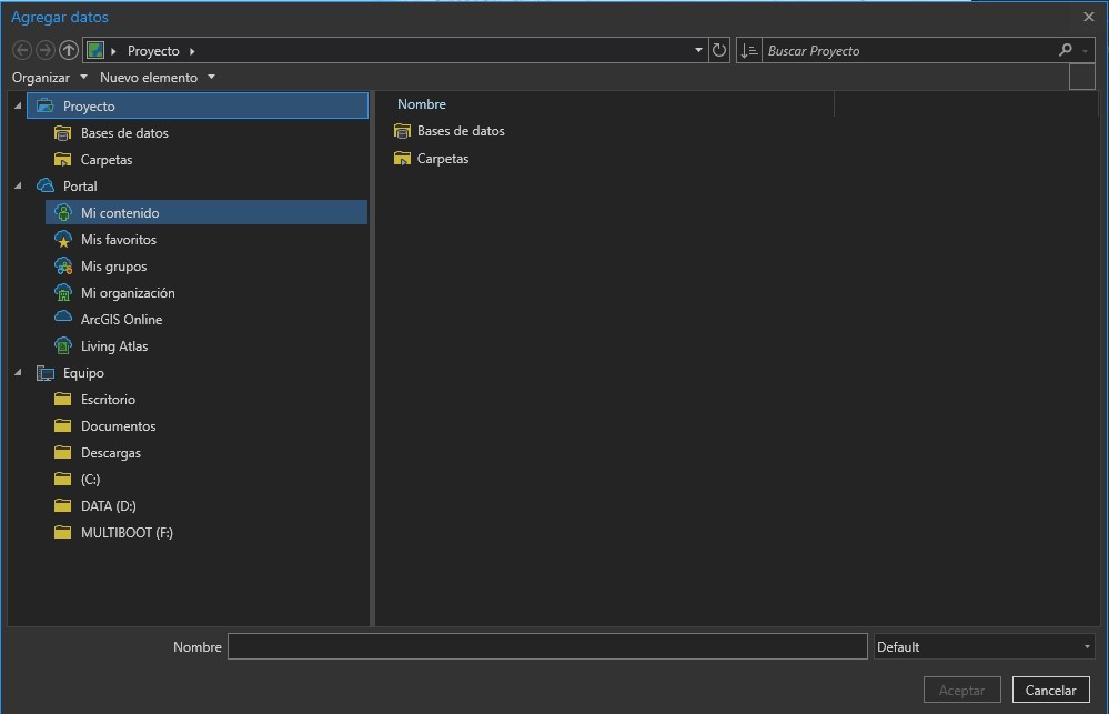

15 minutes later ...

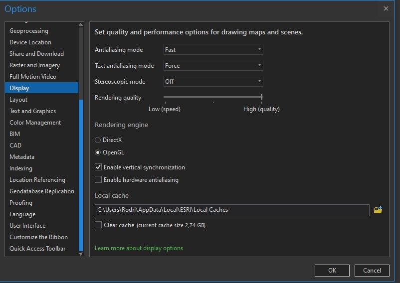

This is the configuration of my display

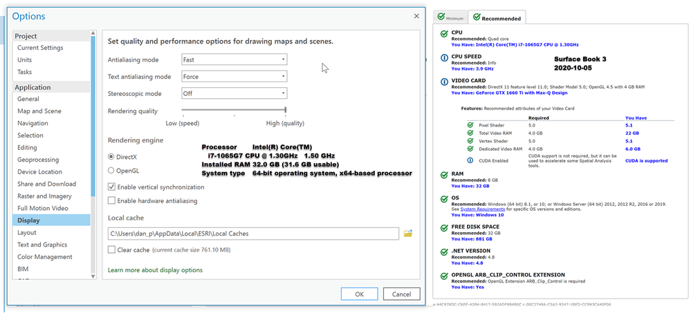

Surface Book 3 (fully loaded).  My Pro settings and the can you run it test results.
I don't have issues at all, so I haven't played with other settings.  No point for me.
