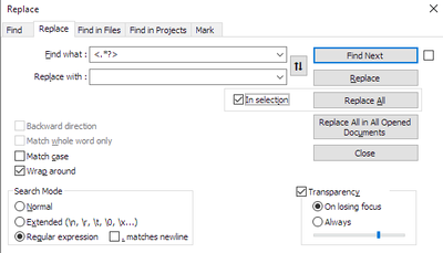

I was able to remove HTML tags by doing this workaround:
  • From the content panel, save the project in "mapx" format (right click , save as Map File)
  • Open the .mapx file in Notepad++
  • Select all lines having HTML tags, except the lines that are part of "binaryReferences" at the bottom of the file.
  • Set notepad++ to search for RegEx value : <.*?>, and replace by nothing.
    • This will remove everything between "<" and ">", including "<" and ">"jalary_0-1663077859735.png
  • Save modifications and import the ".mapx" file in ArcGIS Pro (or just double click on it)
After this workaround, map services on ArcGIS Server doesn't have html tags
