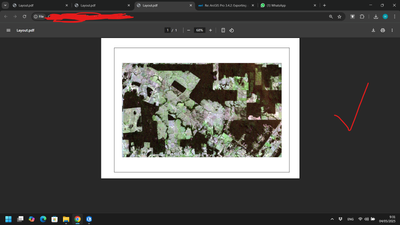

In the screenshot below, I exported a layout containing imagery as a PDF. The PDF was successfully generated; however, the imagery is missing from the output.
What could be causing this issue?

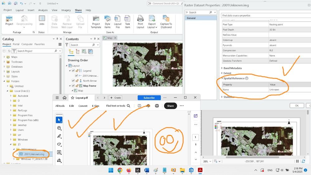

Setting the coordinate system of the imagery to be “unknown” appears to resolve the issue where the layout is exported successfully
The data is attached
