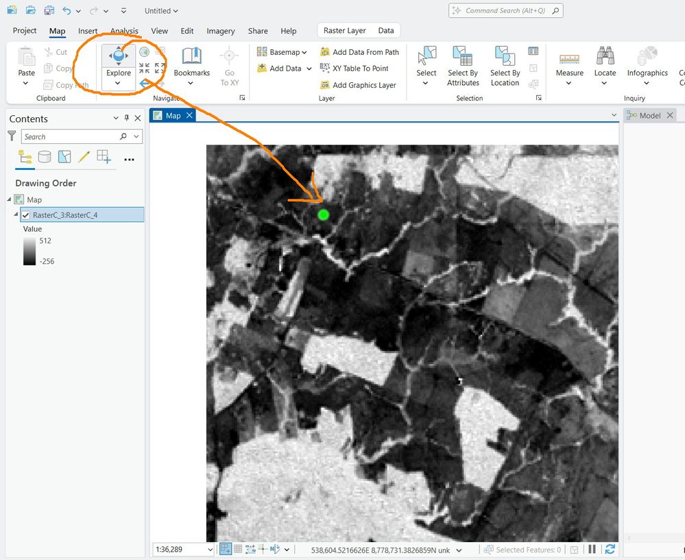

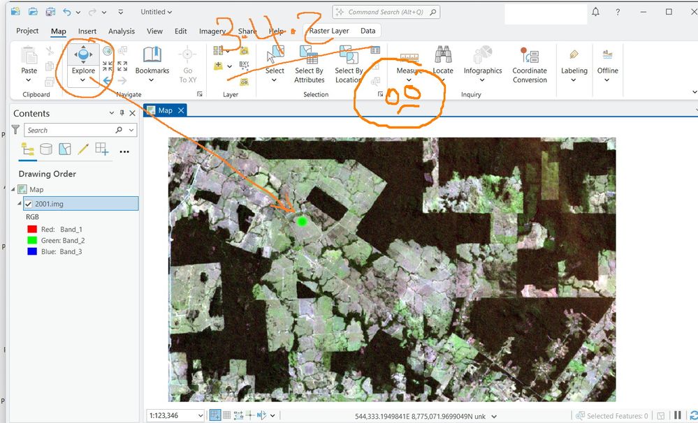

I couldn’t figure out why the pop-up does not appear when clicking a particular cell on a raster
Is this a bug?

This is likely a bug in 3.4.2, as it works fine in previous versions such as 3.1.5.

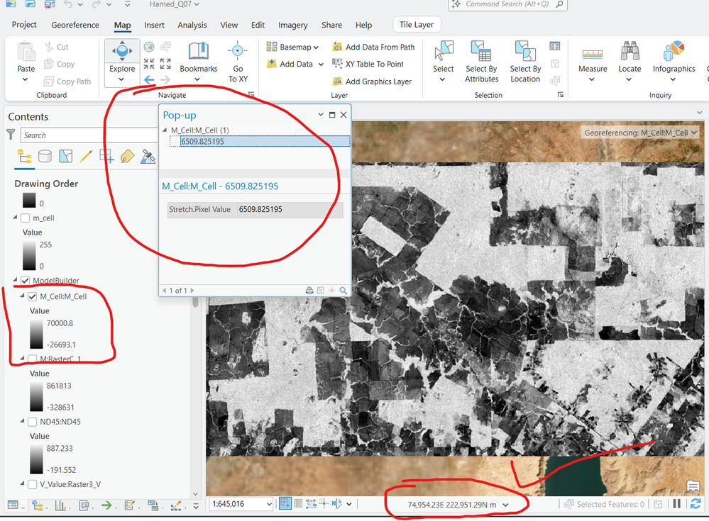

its because the image is outside of the worlds boundaries as you can see from the coordinates below,
i tried georeferencing it back to any basemap boundary and the pop up worked fine on both 3.4.2 and 3.0.2

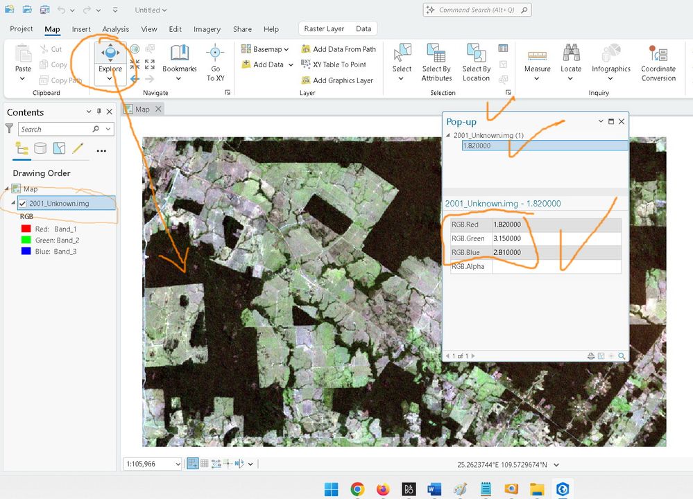

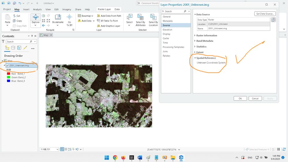

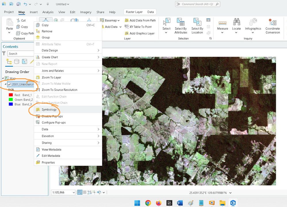

Setting the coordinate system of the imagery to “Unknown” appears to resolve the issue where the pop-up successfully retrieves the cell values.
Tha data is attached
