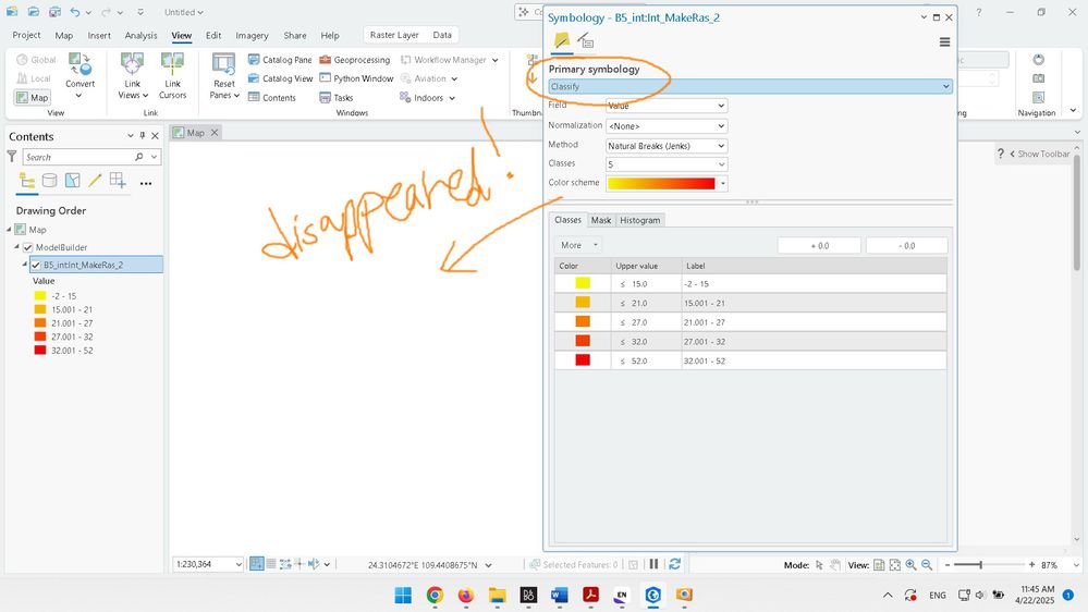

ArcGIS Pro 3.4.2: Selecting “Classify” as the primary symbology causes the raster to disappear,
1298
04-22-2025 01:53 AM
JamalNUMAN
Legendary Contributor

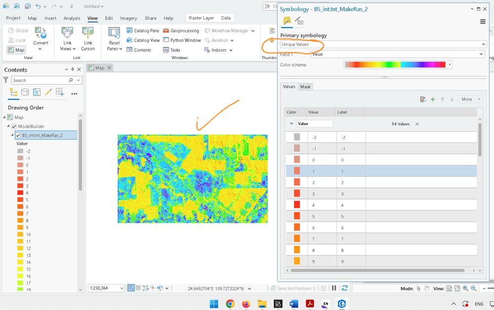

I couldn’t figure out why this happens, especially since the raster displays correctly when using “Stretch,” “Discrete,” or “Unique Values” as the symbology.
What could be the issue here?

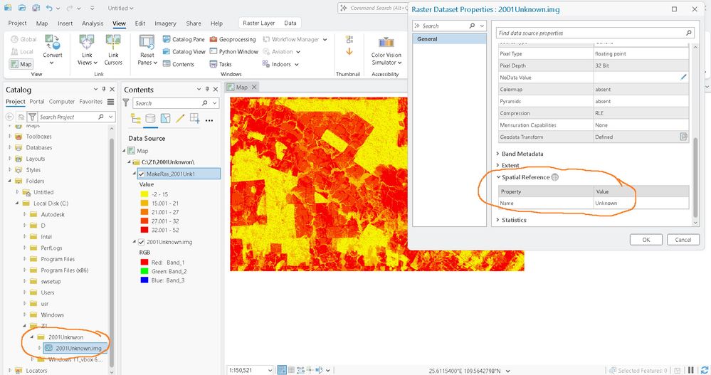

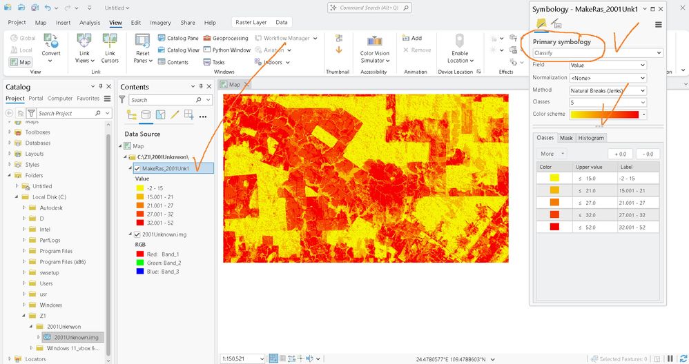

In the screenshot below, using “Classify” as the primary symbology works fine. In which cases does it work, and in which does it not?
Jamal Numan
JamalNUMAN
Setting the coordinate system of the source imagery to be “unknown” appears to resolve the issue where the “classify” works successfully.
