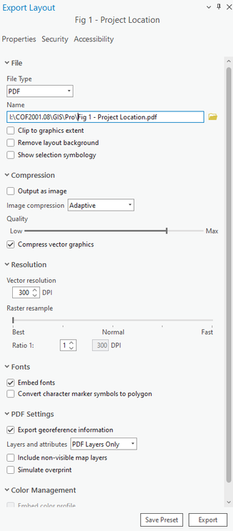

We have not noticed any changes in our PDF exports since updating to 3.3. Here are the export settings we use in case that helps you troubleshoot:
- Holly
