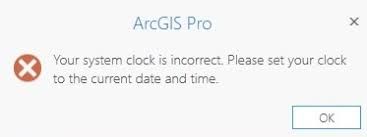

installed ArcGIS Pro 3.1 on a new laptop, but when trying to run it I get the "System clock is incorrect error".
I triple checked system clock, time zone, synced pc time using NTP servers, even checked BIOS clock. Does anyone have an idea what's could be the cause of this?
Thanks in advance,

Had the same problem. Licence was valid so it was the actual time problem. My computer also could not sync time to any internet time. Tried US, EU, Google time servers etc. It just could not do it (Windows 10).
So I manually set the time, but you need to set it exactly, including seconds.
I used www.time.is to find the local time with seconds countdown as well.
I then opened Control Panel > Clock and Region > Set the time and date > Change date and time
The Control Panel clock settings allow you to enter seconds as well, the absurd Windows secondary time settings where you right click the taskbar time and go to Adjust date/time does not have seconds.
Then I made sure to enter the exact hour and next minute with 00 in seconds, then waited for the time.is clock to change to that minute and clicked OK. Now my time was "synced" with the time.is internet time and ArcGIS Pro managed to start without the error.
