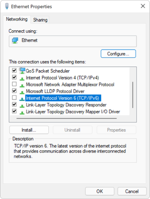

Hello @MWager , just a quick check for you - do you only see this problem with machines that have IPv6 disabled ?
Open "Network and Internet Settings">Change Adaptor Options>Right click the connection and choose Properties.
