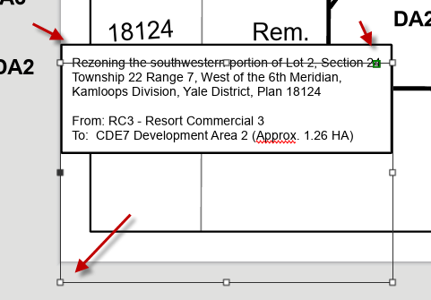

Having troubles with text boxes in ArcGIS Pro 3.2 layouts. Pro seems to be treating them differently than in 3.1. Moving them causes them to relocate to some random spot, resizing is inconistent, and moving a callout moves the whole thing somewhere random. I tried doing the same thing on the same project in 3.1 and it behaves as expected.
3.2: doesn't seem to recognize the object properly.

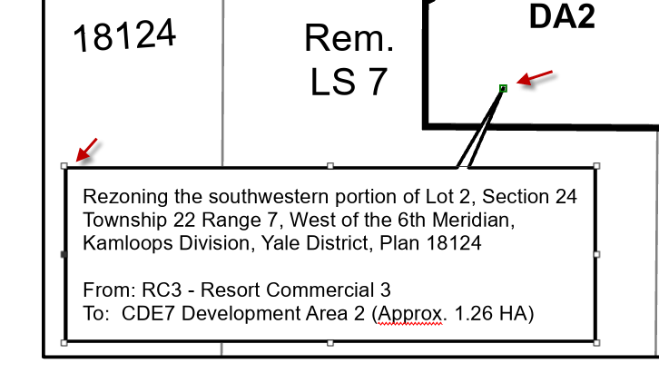

3.1: behaving as expected.
