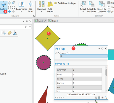

Navigation—ArcGIS Pro | Documentation
The default tool for maps and scenes is the Explore tool Explore Tool, which is used to move, pan, identify feature attributes via a pop-up, and zoom in and out of maps and scenes.
See the accompanying help document for functionality with that tool

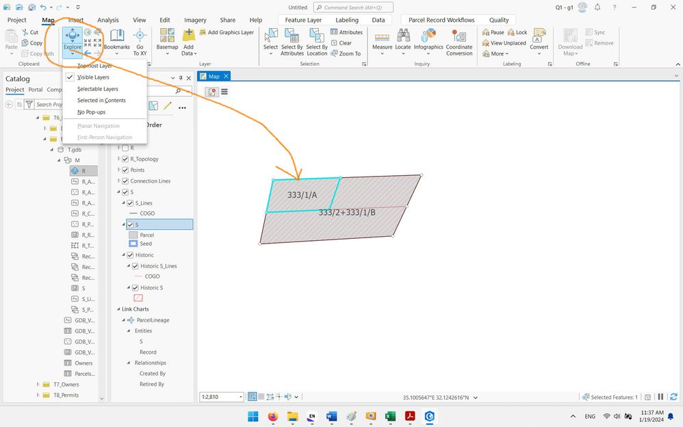

How come the “explore” tool behave as if it is a “select” tool?

I don't know in your case, but I have it set up with popups enabled so when I click on the feature, it gets selected and a popup appears

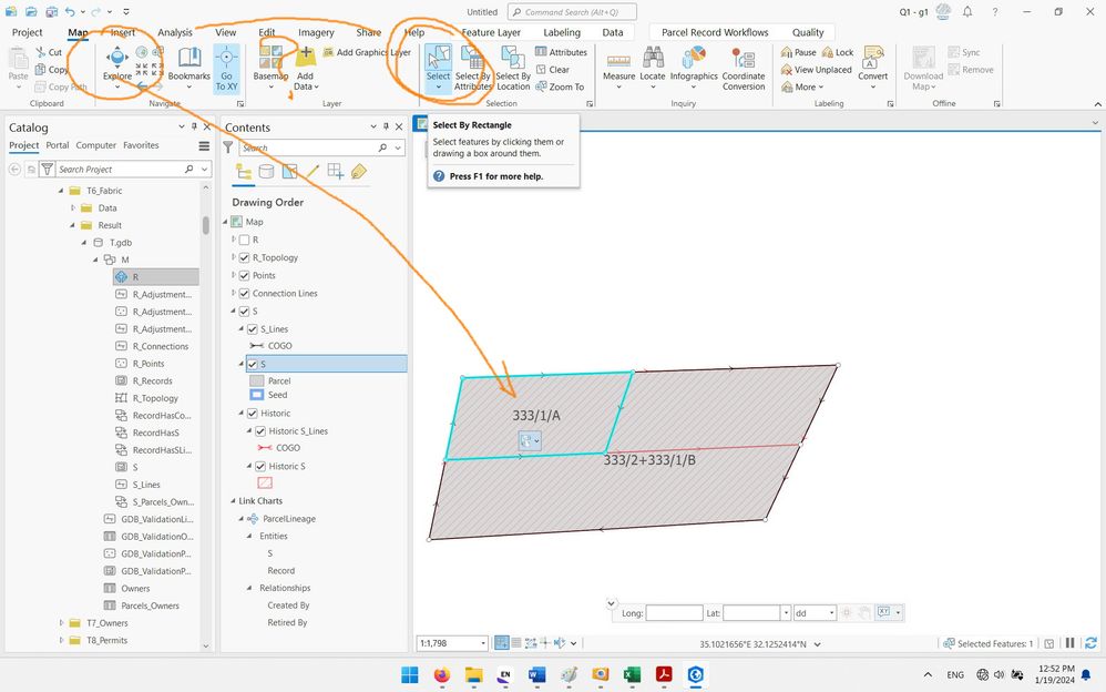

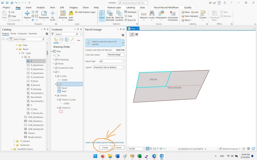

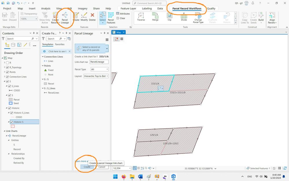

To replicate the issue, please, follow the steps below:
  • Add the fabric (attached)
  • Click “parcel lineage”
  • Select the indicated parcel (as per the screenshot)
  • Press create
  • AFTER THE ABOVE STEP, if you use the “explore” tool, it will be selecting the clicked features instead of popping-up the data
Is this a bug or by design?

I’m not creating features here! I’m creating lineage!

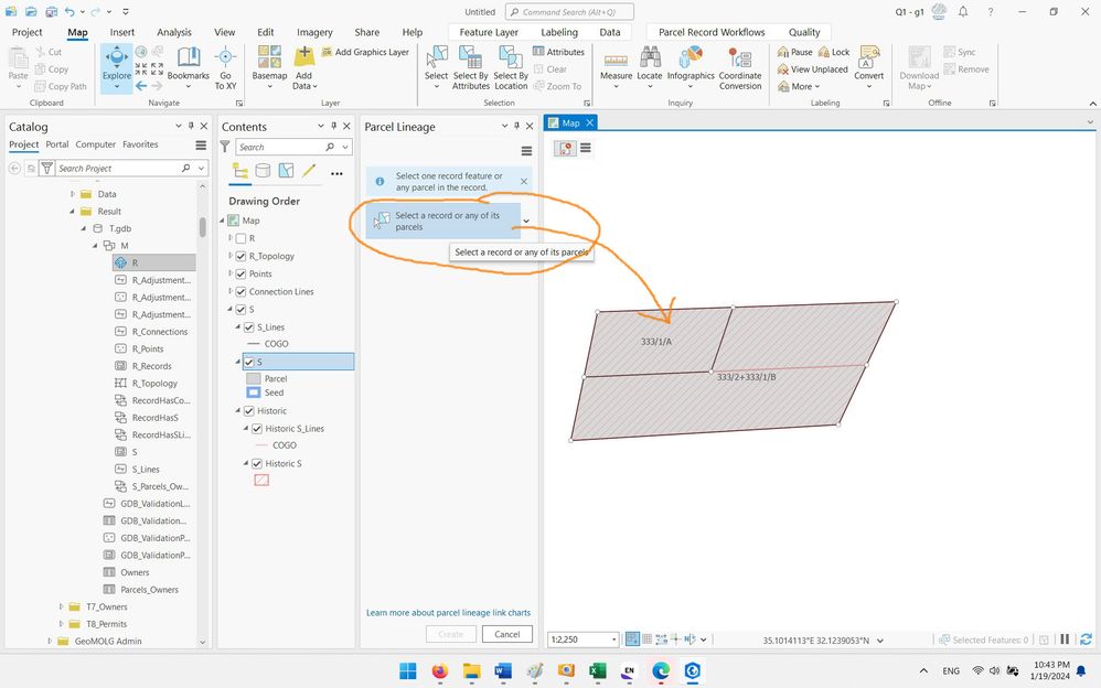

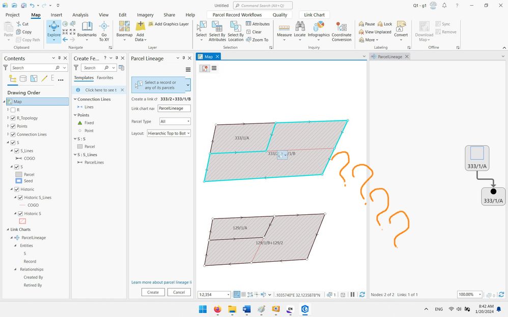

Please, have a look on the screenshots that better illustrate the workflow to replicate the issue
  1. Select the feature for which you need to create the lineage
  2. From the lineage pane, click create so that the lineage chart is create for that parcel
  3. Now, if you press the “explore” tool and then click the target feature, it will be selected instead of having the data popped up!

BSBlagojevic
Understood. YES! On the screenshots looks strange, actually as BUG. (?!?). In AGP version 3.0 and 3.2 Identify function (explore tool) not working correctly on related data; in 3.0-3.04 (not checked later Paches) explore tool doesn't return correct data. In 3.2 can't to return any related without adding related table to map! I can't explicitly say that this related to your case but obviously (on some way) related to Identify function. Maybe contacting support to confirm or reject this skepsis is best solution.
