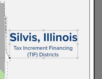

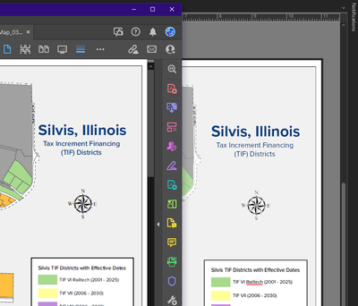

More export issues, this time with alignment. I'm getting a new PC within the month and I'm just going to request 3.0 be installed.
Closed & reopened the project -- the title group now shows in the same location in the exported PDF. Not where I put it nor what it showed me prior to reopening.
