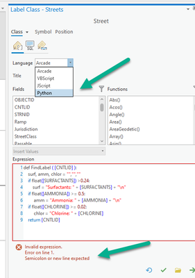

I recently upgraded from 2.7 to 3.0.4. This code worked perfectly in 2.7 but seems to have stopped working after I upgraded. I've seen similar posts to this but I don't know if the issue was ever resolved.
def FindLabel ( [SURFACTANTS], [AMMONIA], [CHLORINE] ):
surf, amm, chlor = "","",""
if float([SURFACTANTS]) >0.24:
surf = "Surfactants: " + [SURFACTANTS] + "\n"
if float([AMMONIA]) >= 0.5:
amm = "Ammonia: " + [AMMONIA] + "\n"
if float([CHLORINE]) >= 0.02:
chlor = "Chlorine: " + [CHLORINE]
return surf + amm + chlor
The error message I'm getting is:
Invalid expression.
Error on line 1.
Semicolon or new line expected
I'm not sure where a semicolon or new line is expected, but I'm hoping it's an easy fix

Well, it appears as if Pro labeling likes the [] instead of !! for the field names, However, the only  way I get the same error message is if I fail to switch the language to Python "before" I paste in the code.
R_

I'm no Python expert but I have used expressions for labeling and I have used the FindLabel function like you shared in your graphic. To my knowledge, that isn't the syntax for python. That is the syntax for VBScript.

This fixed it! I'm glad it was something small like that and not a syntax error. Appreciate the help!
RhettZufelt
MVP Notable Contributor
I thought that the variables were being called with VBScript syntax, but according to the documenation, and the fact that clicking/building it in Pro's label editor populates it this way, I tried it and it works.  It appears as if the python syntax/variable delineators are different in label expressions vs calculate epxressions (where fields are referenced with !field!).
