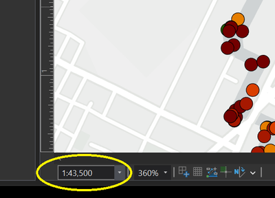

Mahdi_Ch
When you Activate the mapframe in layout view look at the bottom left corner, there is a drop up! list that you can manually edit its value to the right scale. Pick something between those values that are too big or too small.
