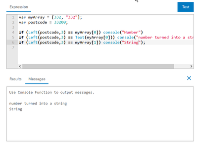

For your code to work, the value of myArray[f] must be a string. If it's a number, it won't work. You have to use this syntax if it's a number
if (Left(city.postal_code,3) == Text(myArray[f])) {
Here's a demo of that in the playground

Fantastic! Good to know array values has to be casted to text for 'if' statments... Very useful.

You have to cast the value array to Text since "Left(city.postal_code,3)" is also a Text.
