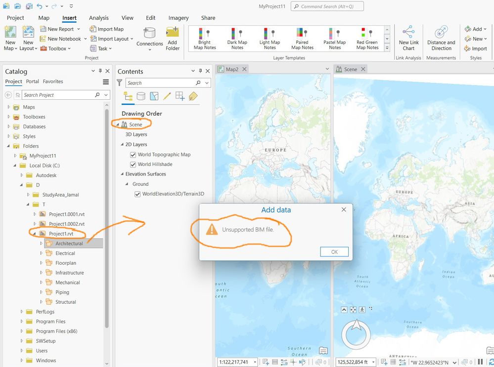

The rvt file fails to be inserted and ends up with “unsupported BIM file” error.
What could be the issue?

The Help indicates that version dependence might be the problem and explain the error message:
ArcGIS Pro supports Revit file versions 2018–2023. . . . Attempting to use unsupported BIM file versions will invoke the error message: Unsupported BIM file.
https://pro.arcgis.com/en/pro-app/latest/help/data/revit/what-is-bim-data-.htm#ESRI_SECTION1_414424A...

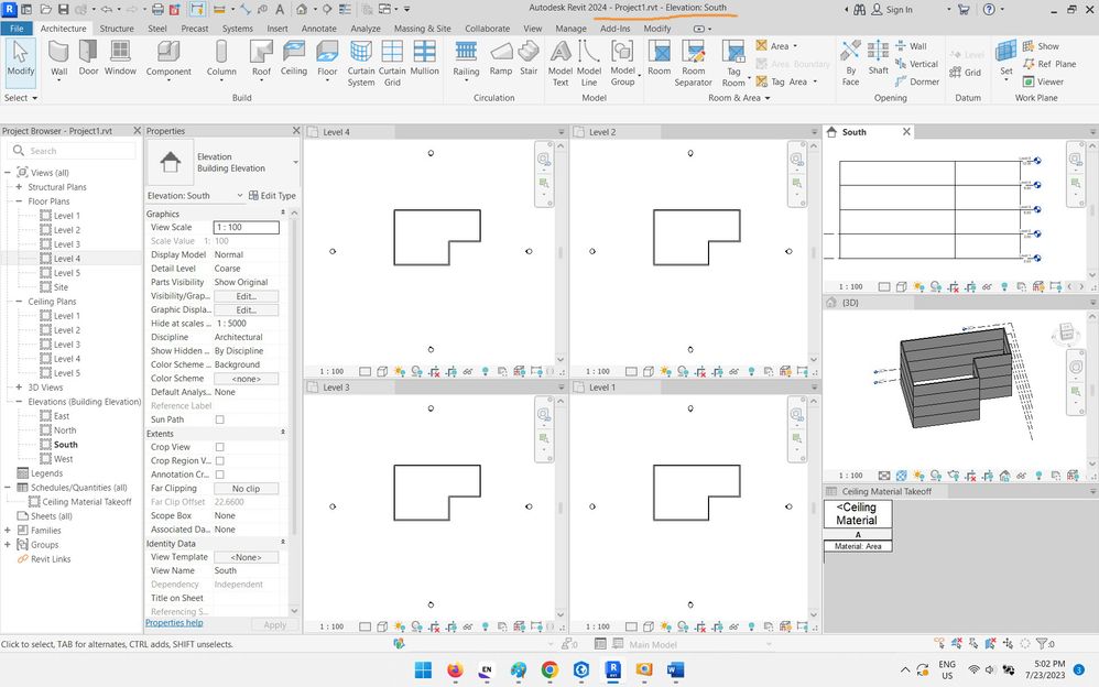

The Revit 2024 is not supported in ArcGIS Pro while there is no way to downgrade the Revit 2024 to lower version.
How to resolve this dilemma?

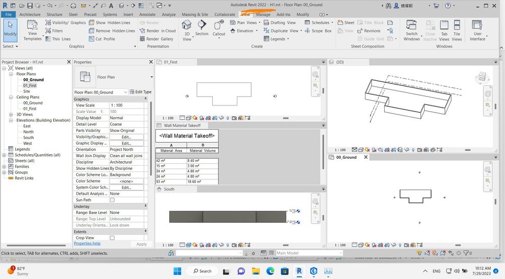

JamalNUMAN
Legendary Contributor
Pro 3.0.2 works fine with Revit 2022
