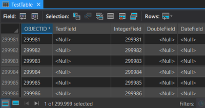

Indexes speed up everything that uses WHERE statements. I don't know if the search feature does that, it's possible that you won't get a speed boost here.
But there is a noticeable difference in selecting a record (table from a fgdb, can't test in an egdb right now):
from timeit import timeit
timeit(lambda: arcpy.management.SelectLayerByAttribute("TestTable", "NEW_SELECTION", "IntegerField = 172649"), number=100)
#301.5261236000006
timeit(lambda: arcpy.management.SelectLayerByAttribute("TestTable", "NEW_SELECTION", "OBJECTID = 172649"), number=100)
#244.7347675000001
A query on the non-indexed field took 3.01 seconds on average. On the indexed field it took 2.44 seconds, that's a 20% speedup.

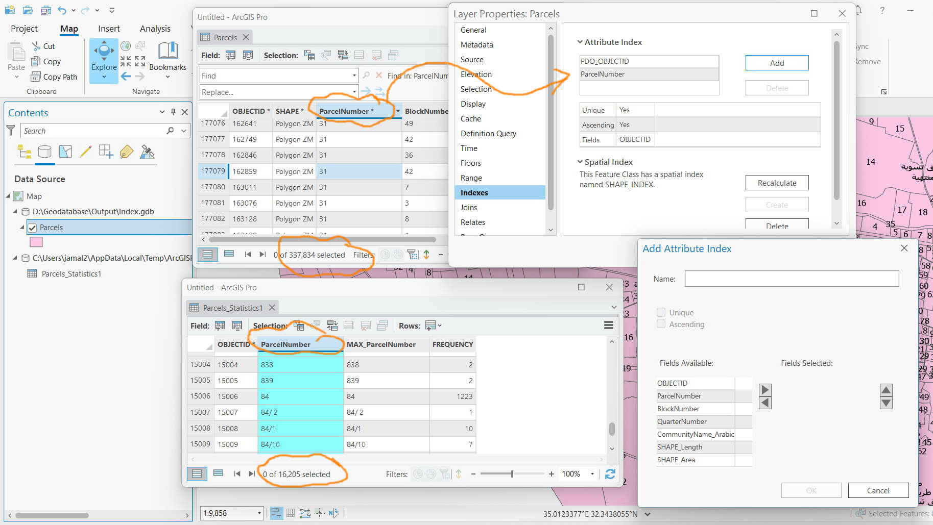

JamalNUMAN
Legendary Contributor
If indexing is all about enhancing the performance in searching the data stored in a table, then how to prove that this performance is enhanced as indexing is applied? How it can be felt?
For example, in the screenshot below, what is the difference between searching the parcel #73 with and without indexing?
Jamal Numan
JoshuaBixby
MVP Esteemed Contributor
Honestly, I am not even sure if the Find or Find & Replace dialogs rely on indexes.  Indexes are used by database engine software to determine optimal execution plans.  In the case of the Find tool, it might just be using a cursor to iterate through records and checking field values that match.

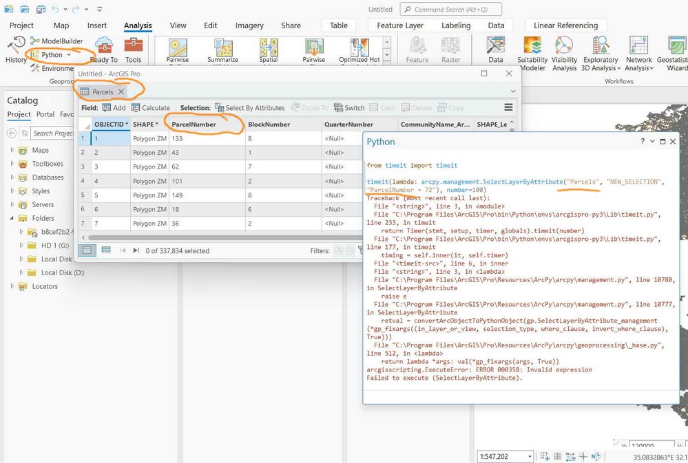

JamalNUMAN
I tried the script on my data but ends with the error below:
What could be the issue here?
timeit(lambda: arcpy.management.SelectLayerByAttribute("Parcels", "NEW_SELECTION", "ParcelNumber = 72"), number=100)
Jamal Numan
JohannesLindner
MVP Alum
Your ParcelNumber is probably a text field. SelectLayerByManagement takes a SQL where clause. In SQL, you have to enclose text values with single quotes:
timeit(lambda: arcpy.management.SelectLayerByAttribute("Parcels", "NEW_SELECTION", "ParcelNumber = '72'"), number=100)
Have a great day!
Johannes

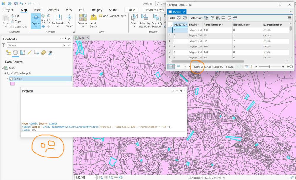

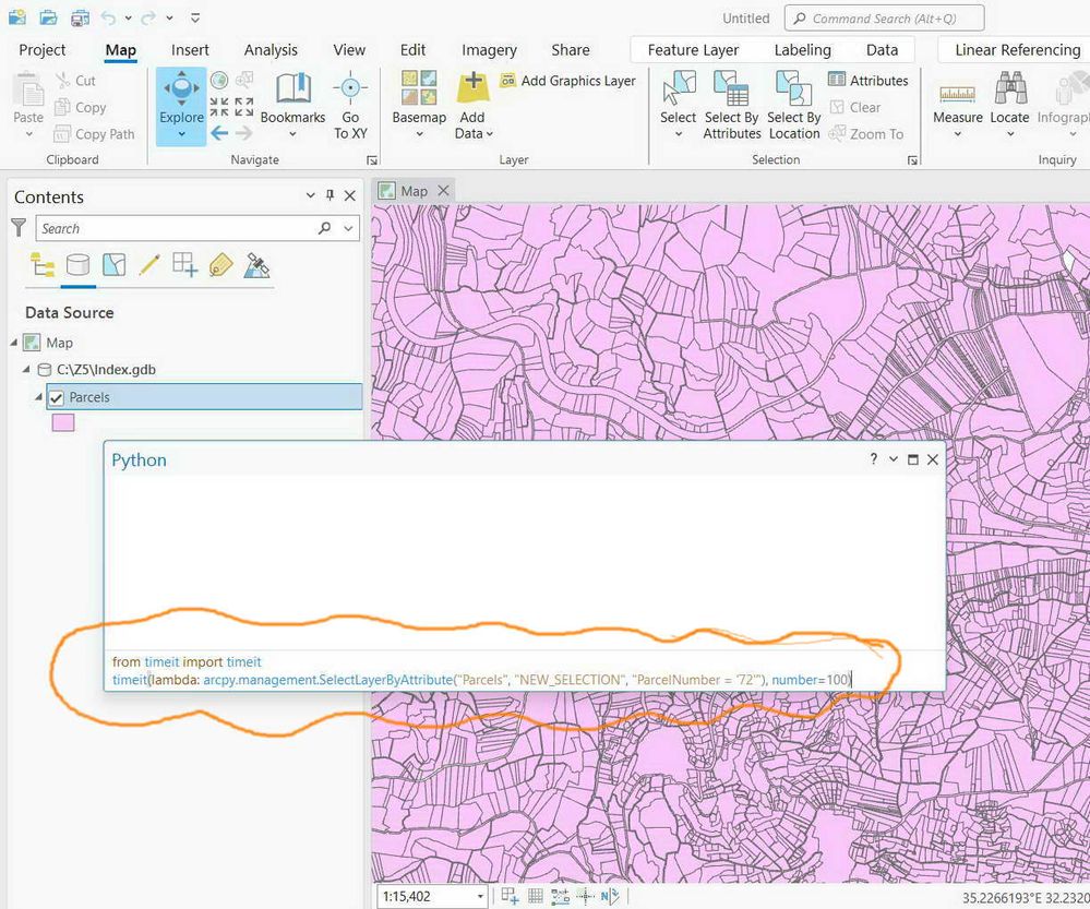

JamalNUMAN
It works fine but the time is not displayed.
How to display the time?
Jamal Numan
JohannesLindner
MVP Alum
Huh, it just prints out the time for me...
t = timeit(lambda: arcpy.management.SelectLayerByAttribute("Parcels", "NEW_SELECTION", "ParcelNumber = '72'"), number=100)
print(t)
Have a great day!
Johannes
