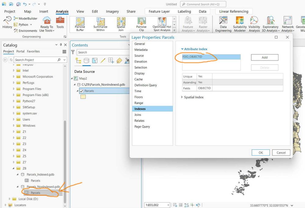

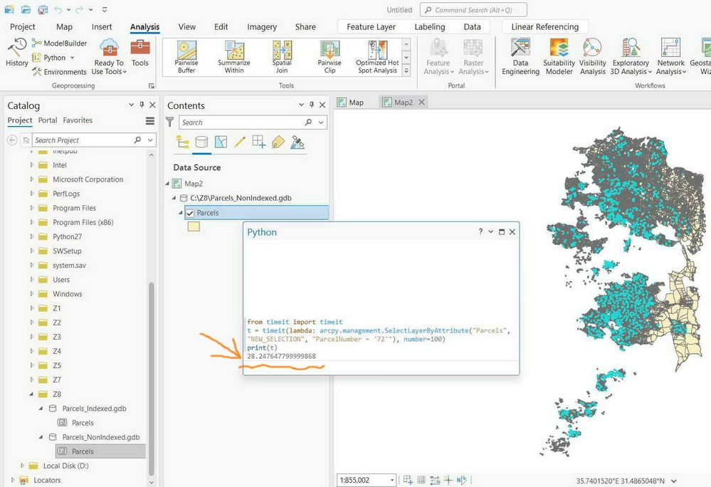

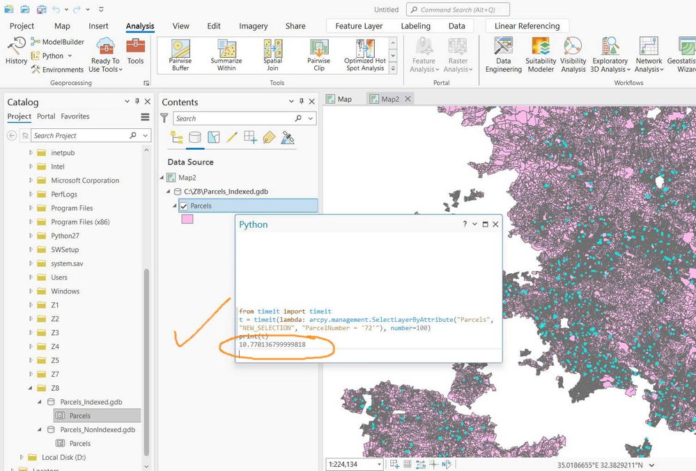

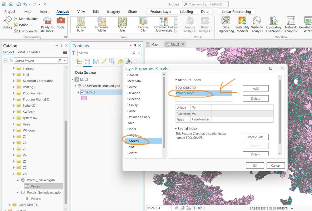

To determine whether things would be sped up using indices, you would obviously have to perform a query before and after indexing, timing both.
If the queries are taking an inordinately long time, then the root problem may lie elsewhere, like location of the data, network issues (if applicable), hardware etc etc.

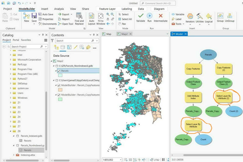

I’m wondering if there is a tool that can measure the time consumed in performing the “select by attribute” tool in the model builder. This way we can easily compare between querying in indexed and nonindexed feature classes.
