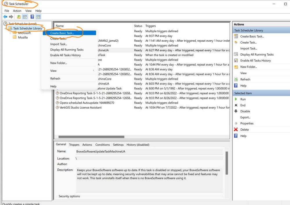

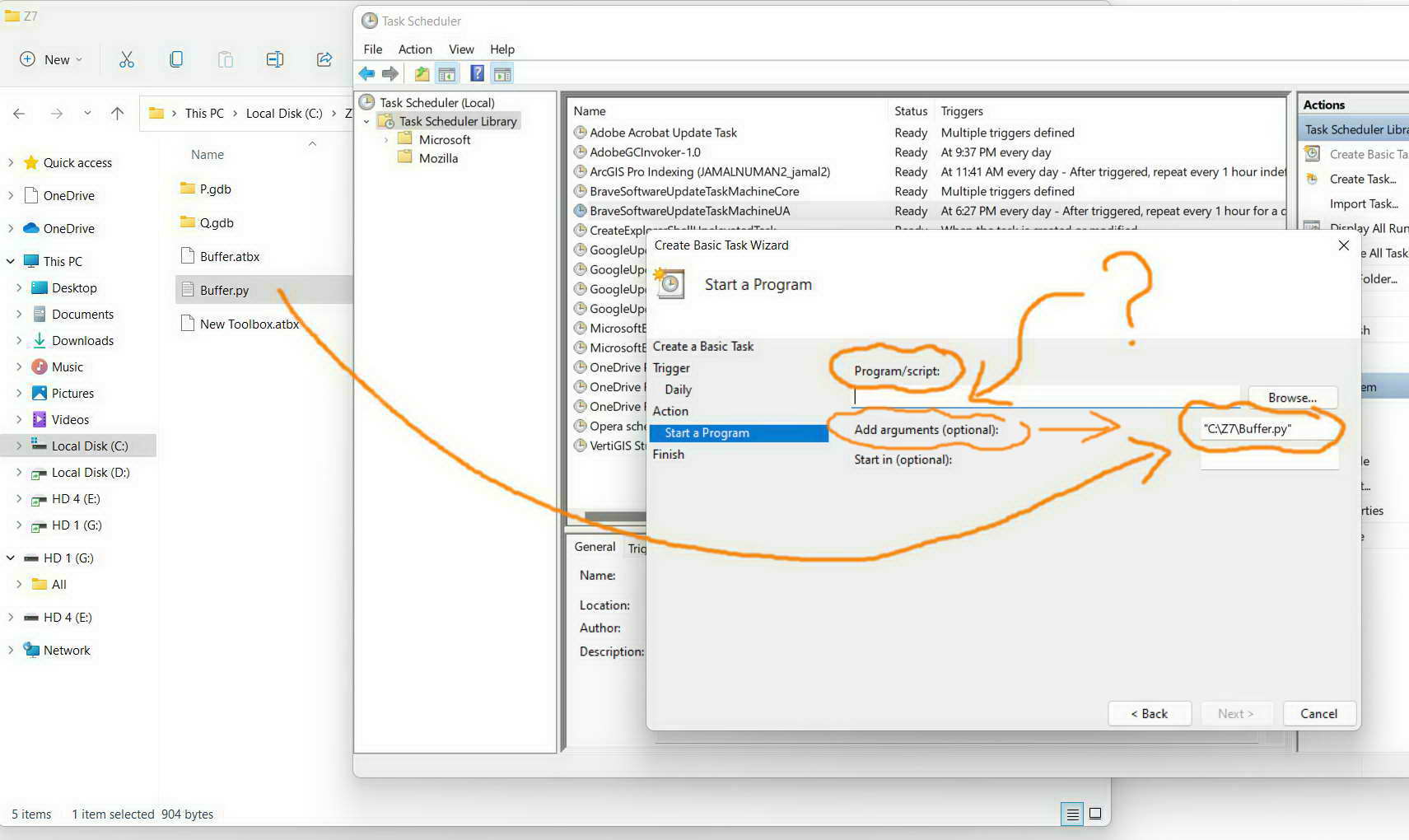

In the screenshot below, I wanted to run a python script that performs the buffer for a given feature class. I fill the “buffer.py” script in the “add argument” box but couldn’t figure out what to stick in the “Program/scrip” box
Jamal Numan
13 Replies
RichardHowe
The script (.py file) goes in the "program/script" box. You don't need any arguments!

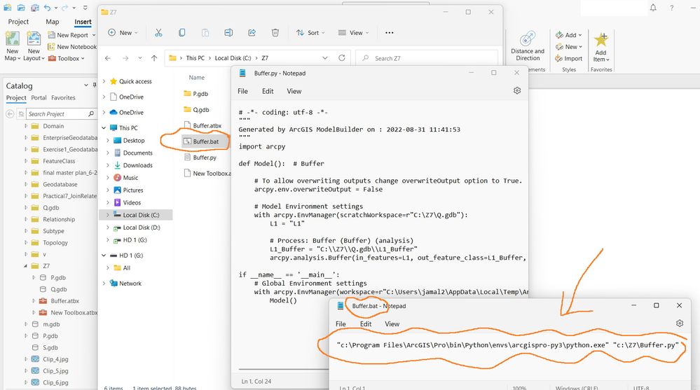

Try copying and pasting the following into notepad:
"c:\Program Files\ArcGIS\Pro\bin\Python\envs\arcgispro-py3\python.exe" "c:\Z7\Buffer.py"
And saving with a .bat extension. Then pointing task scheduler to that
JamalNUMAN
Legendary Contributor

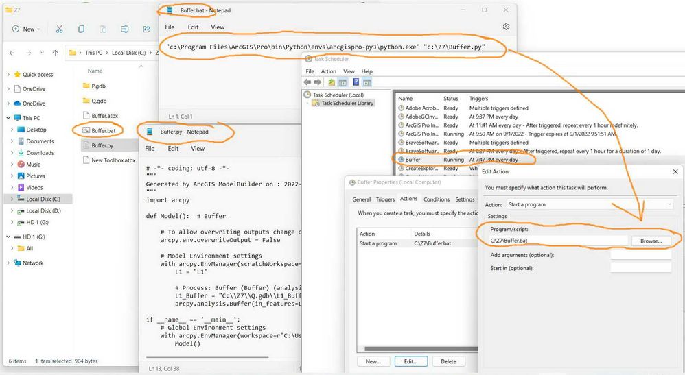

The .bat file appears not to work as per the screenshots below
Jamal Numan
MichaelVolz
Esteemed Contributor
Can you provide a screenshot of your bat file code?
JamalNUMAN
Sure. Here you go
Jamal Numan

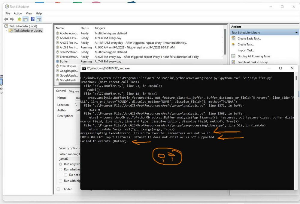

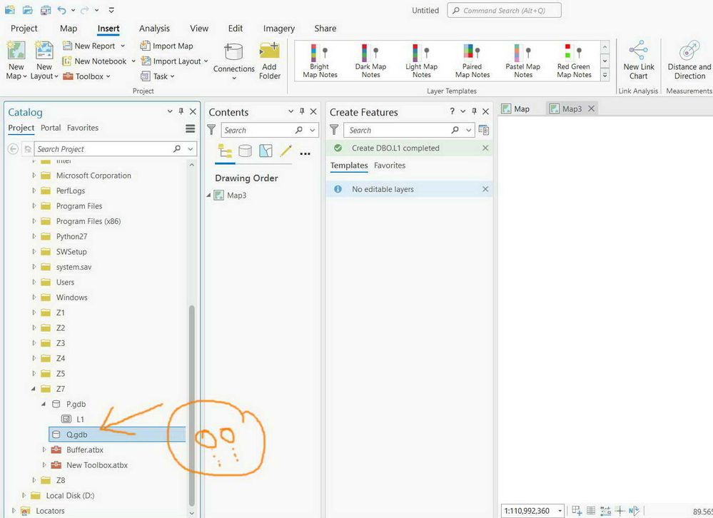

RhettZufelt
MVP Notable Contributor
I don't see anywhere that creates the C:\\Z7\\Q.gdb\\L1 feature class?
I see where you try to use it as an input feature class, but by the lack of arrow next to the Q.gdb, that would suggest the FGDB is empty (is there an existing L1 feature class in the Q.gdb?).
If not, the buffer tool can't use a non-existent dataset as an input.

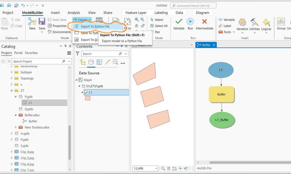

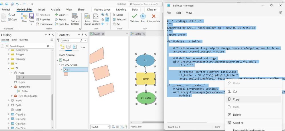

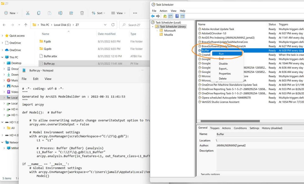

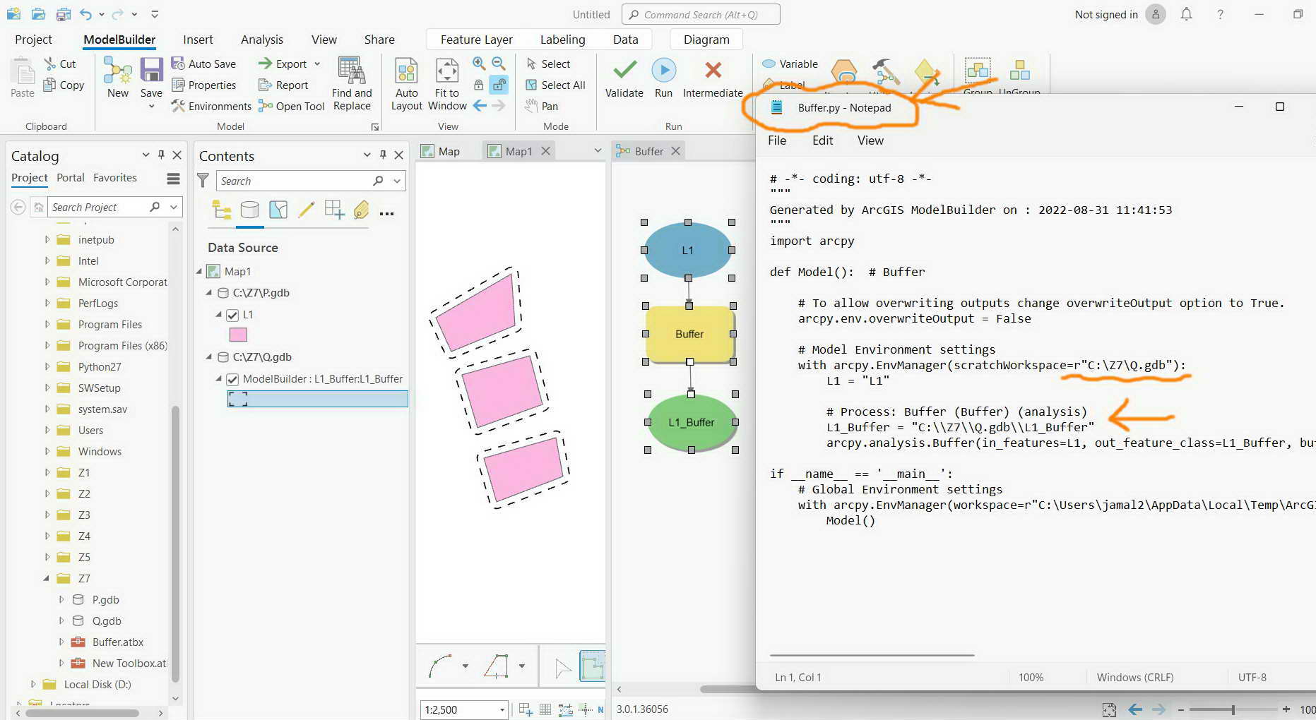

All what I wanted here is to run the buffer tool by windows task scheduler. The python script is extracted from the model. It runs successfully thought the Pro as per the screenshots below.
# -*- coding: utf-8 -*-
Generated by ArcGIS ModelBuilder on : 2022-08-31 11:41:53
import arcpy
def Model():  # Buffer
    # To allow overwriting outputs change overwriteOutput option to True.
    arcpy.env.overwriteOutput = True
    # Model Environment settings
    with arcpy.EnvManager(scratchWorkspace=r"C:\Z7\Q.gdb"):
        L1 = "L1"
        # Process: Buffer (Buffer) (analysis)
        L1_Buffer = "C:\\Z7\\Q.gdb\\L1_Buffer"
        arcpy.analysis.Buffer(in_features=L1, out_feature_class=L1_Buffer, buffer_distance_or_field="5 Meters", line_side="FULL", line_end_type="ROUND", dissolve_option="NONE", dissolve_field=[], method="PLANAR")
if __name__ == '__main__':
    # Global Environment settings
    with arcpy.EnvManager(workspace=r"C:\Users\jamal2\AppData\Local\Temp\ArcGISProTemp13328\3aee01c4-83fc-49dc-a1a9-1160767de7fc\Default.gdb"):
        Model()
Why the script fails to run from the windows task scheduler?
