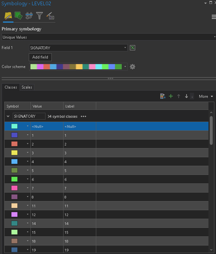

I'm trying to re-make some unique values symbology.  To speed up the process: How can I make Pro stop using the domain values and start using the coded descriptions?

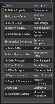

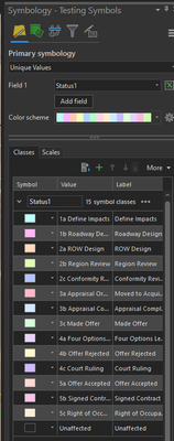

I'm using ArcGIS Pro 2.9.1 and when I bring in my data that has a domain with numbers and coded description, it throws in the labels appropriately.
Is your domain set up in the Domains sections with the appropriated coded descriptions? This is mine:

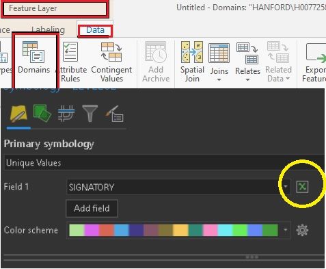

couple things you can check. 1). does domain table exist properly 2.) perhaps you have a unique value expression that was written to display unique values at a particular fashion. Chcks.jpg
KeithAddison1
Domain table appears in order, no expression.
