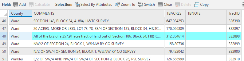

Here, I'm able to preview the long text by hovering over the attribute table

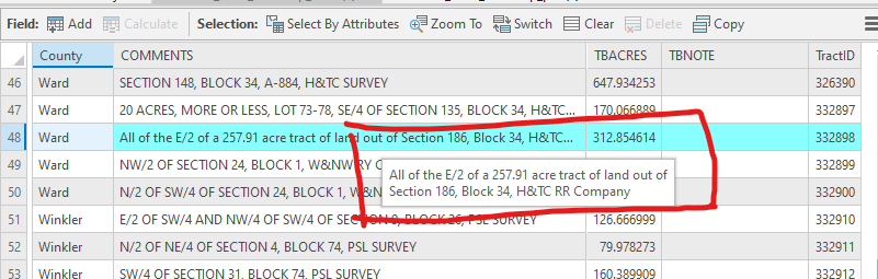

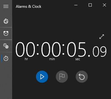

5 seconds later...
Gone.

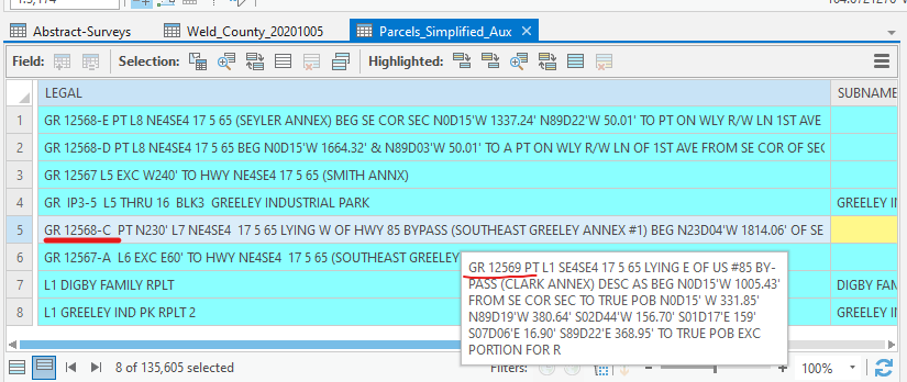

To add to this topic, now the hover tip is showing attributes from a completely different unselected row.
