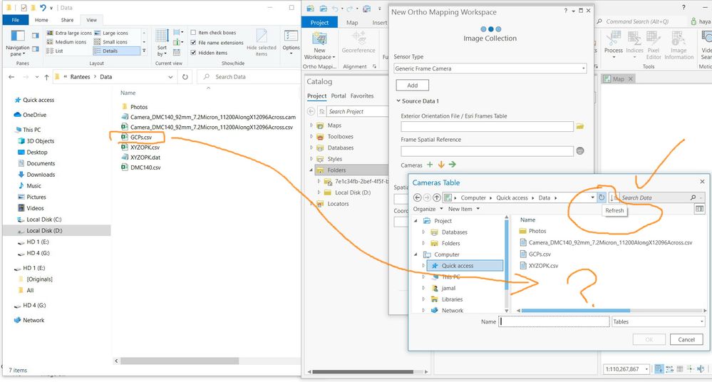

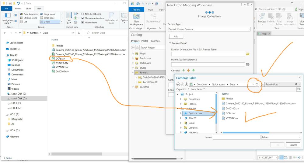

For example, in the first screenshot, Pro manages to detect all files of csv format that are available in Data folder. Now, if new csv file is added to Data folder, then Pro fails to detect it. In this case, one needs to restart the Pro in order to detect all the csv files available in the Data folder.
This issue is not limited to the example above but valid everywhere in the Pro.
Is this by design or a bug?

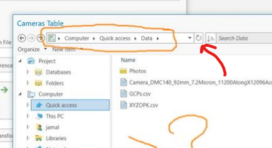

You can also click on this button to refresh the contents.
Have to agree it is one of those frustrating aspects, but I've come to learn that it just happens and clicking that button solves everything. 🙂

JamalNUMAN
Legendary Contributor
Thank you DuncanHornby for the help. This little refresh icon solves the issue
