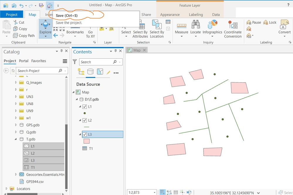

I observed that saving a project as aprx file is taking much of time in 2.7.2. Has anyone experienced this issue in 2.7.2?
