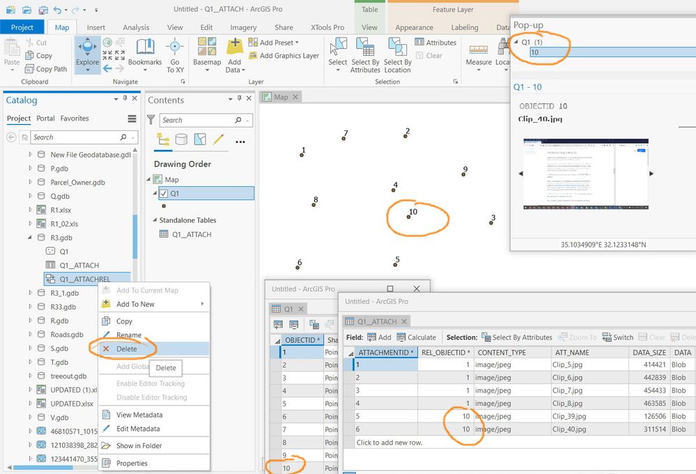

What if the relationship between the feature class and its attachment table is deleted? How to reconnect them so that the photos can be viewed?
If the “relationship class” is re-created between the feature class and its attachment table then the photos fails to view!

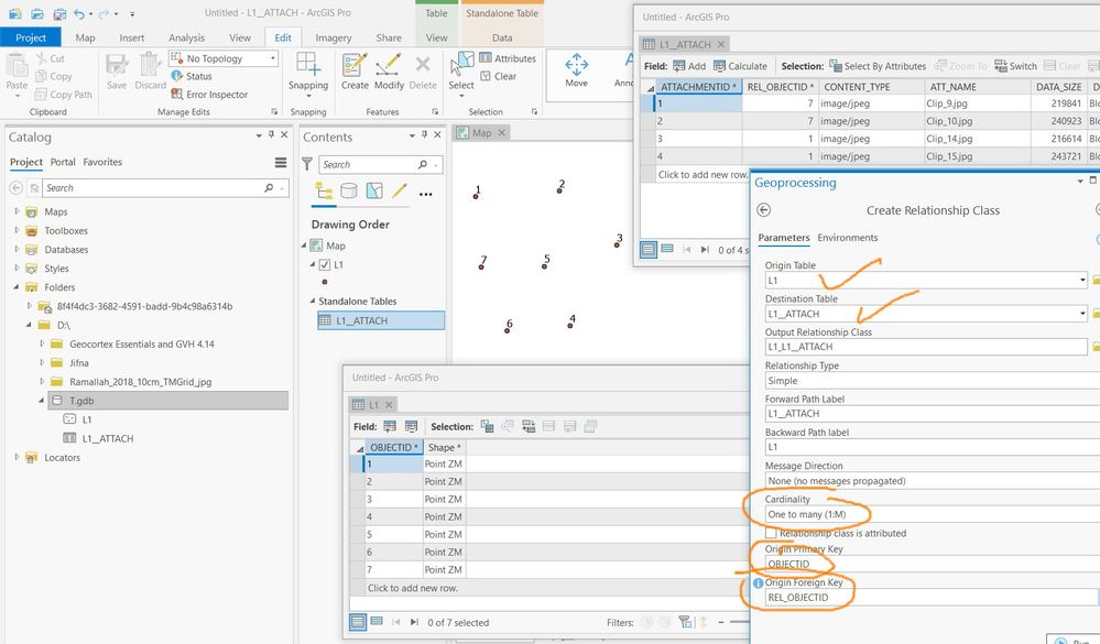

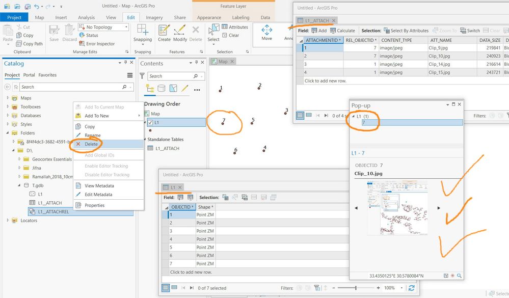

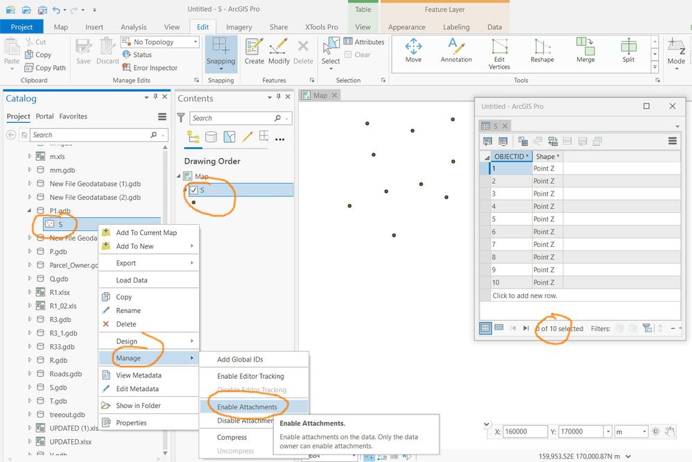

If you try to perform the “enable attachments” option from scratch, you will be finding out that the attachments are saved as per screenshots below
The issue in this thread is to find out how to rebuild the “relationship class” if it’s deleted!

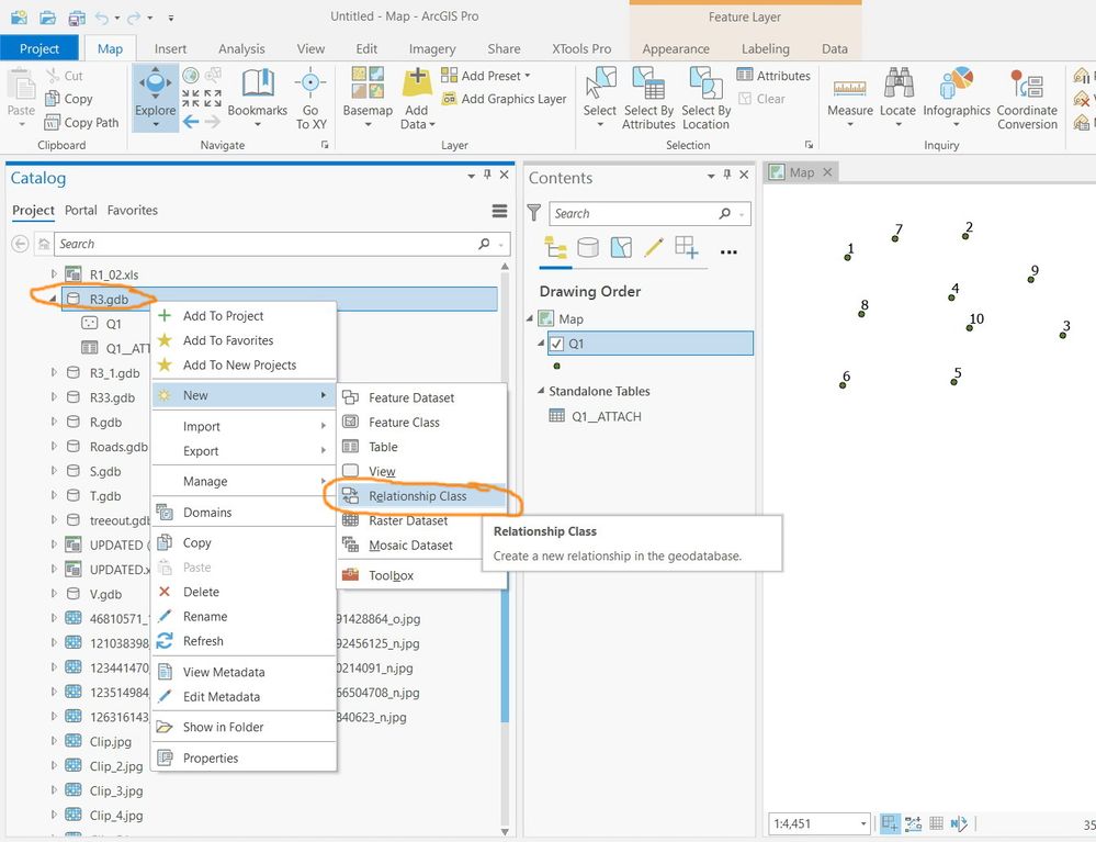

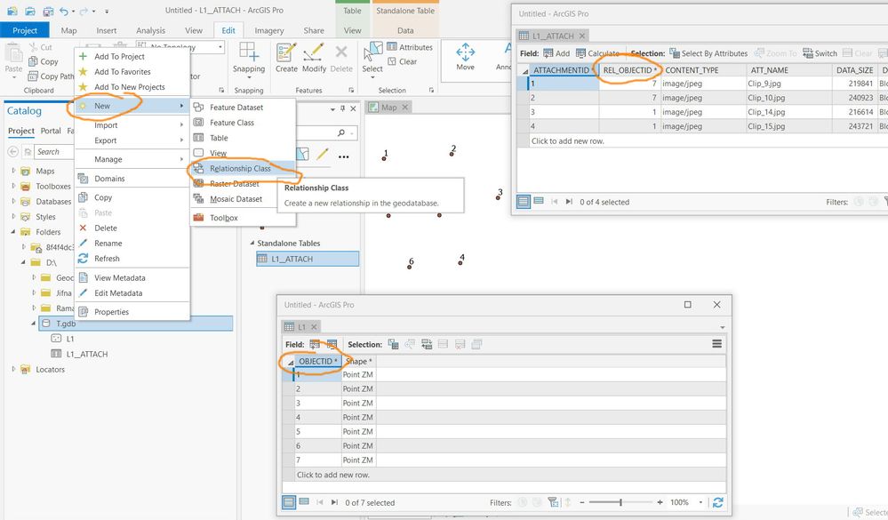

So the question is if by chance sometime deleted the Relationship Class (RC) that is used by the Enable Attachments GP tool/command, is it possible to build a new relationship class to re-enable the existing relationship?  If so, I tried.  I took a screen shot of the Relationship Class (RC) properties before I deleted it.  Deleted the RC.  Rebuilt the RC using the GP tool using the screen shot.  Shut down AGP.  Loaded the project again.  Added the FC with the attachments "rebuilt" of sorts.  Identified a point and it did not show the Attachment.  So I'm guessing the answer is not possible.  Which leads to a question, why would one delete the RC to begin with?  An error?

Right. What if the relationship is deleted by mistake? Is this the end and we are losing everything?

You're welcome Jamal.   So if the relationship class itself is deleted, then the relationship appears to be broken.  I would presume that the data in the relationship (i.e. source data - *.jpgs, *.docx, etc.) is fine.  It's just not related to the feature class anymore.  For example, if I created a RC to a non-spatial table, the non-spatial table still exists as would a folder of *.jpgs.  You would have to rebuild the RC again to re-establish the relationship.

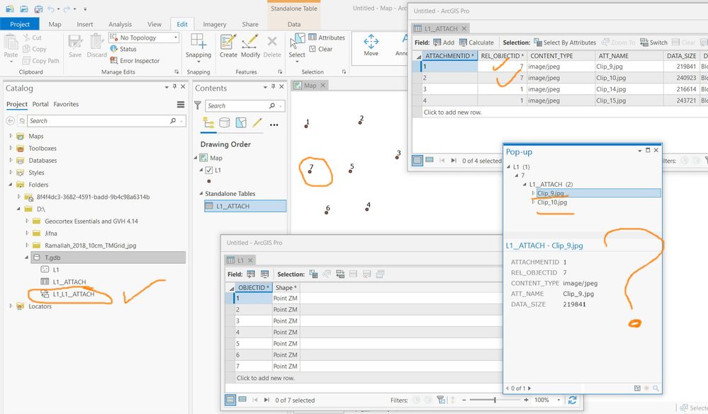

If the attachment relationship is deleted and rebuilt then the photos are not displayed as per the screenshot below

Yes sir - that's what I saw too!

Does this mean that there is no chance ever to reconnect features to their images in case the relationship is deleted by mistake?
