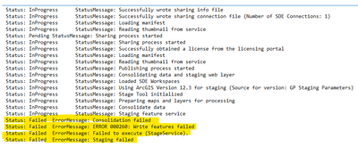

Good morning all, I wanted to follow up on this error.  The original issue was fixed, and it it is much appreciated!  But, on a few sde layers (using views) when I go to overwrite AGOL layers, I get a staging error 000260.  The only way I have been able to get my layer(s) to upload is to export them to my local machine then overwrite the existing web layer.  I hoping there is a way to fix this.  Any input is greatly appreciated!
The error code is posted below:

I am getting the same error. Have you found a way to solve this issue without exporting them into a local geodatabase?

No solution other than downloading local and overwriting it that way.  I thought maybe an issue with the data, but that's not the case.  It's random and sort of rare when it happens, but only happens on enterprise data.
