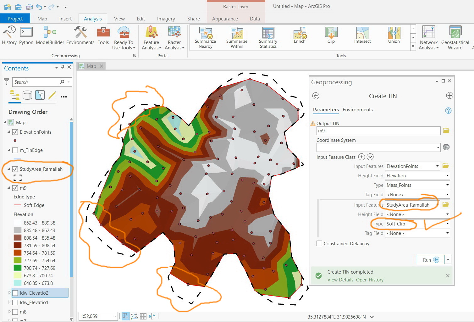

I observed that the “create tin” tool doesn’t respect “environments” settings of “extent” and “mask”.
Is this by design?

It appears that adding an input feature with “soft clip” type resolves the issue. But how can the TIN cover the whole study area?

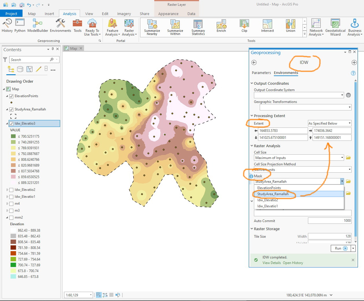

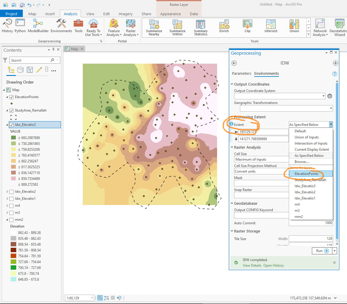

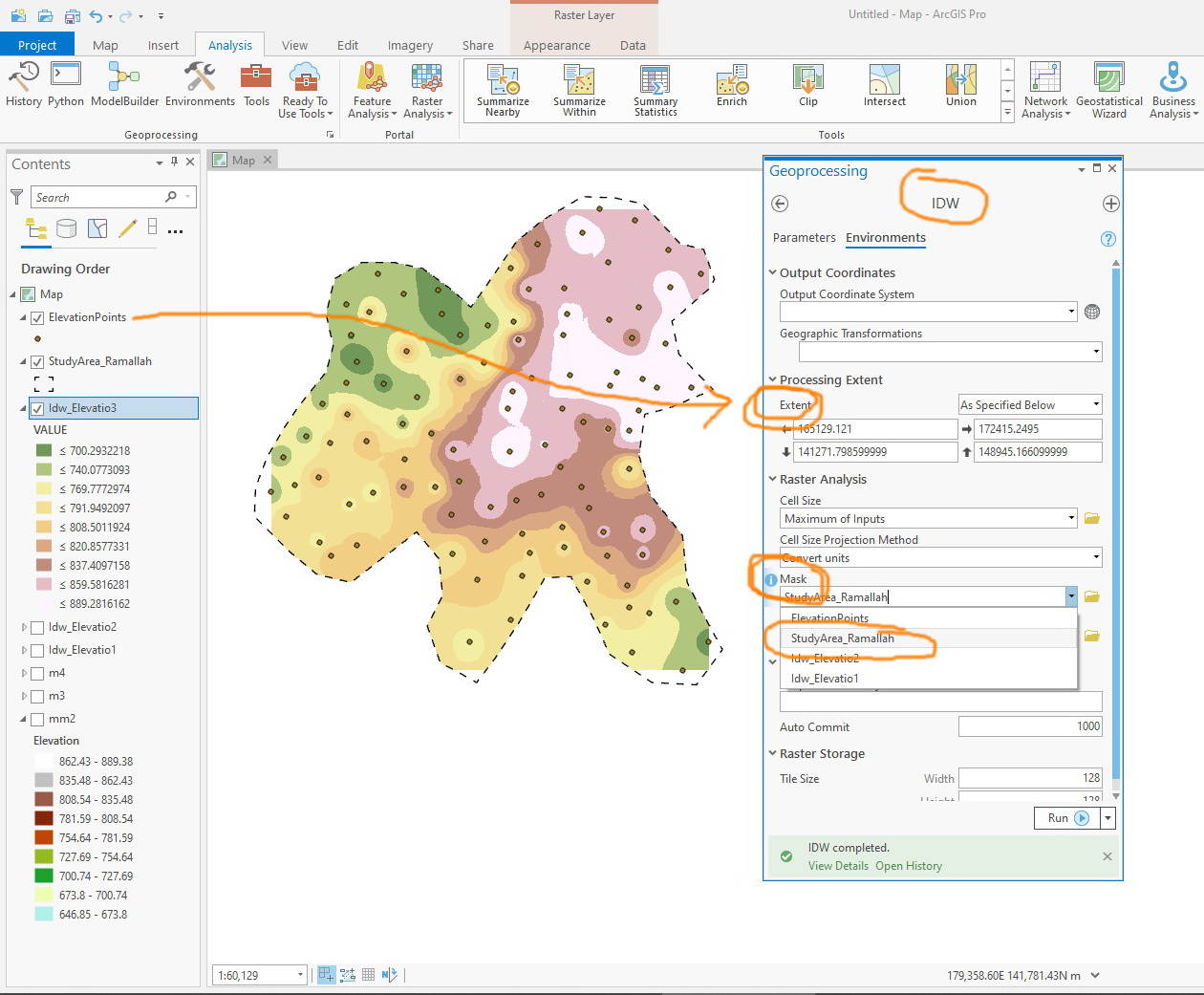

My point here is: I wanted to know if the TIN can cover the whole study area.
For example, if the IDW is run, the following outputs can be obtained depending on the environment settings. The output can be enforced to cover the whole study area. Is this doable in case of TIN?

I understand that IDW can extrapolate, allowing it to cover the entire study area, whereas TIN cannot.
