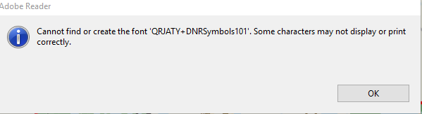

And when I try to open the pdf file I get this error:
Fonts need to be embedded on our maps because they get posted to the web site and sometimes get printed for publications.

After recruiting some help from someone who does not have any ArcGIS products installed it looks like both embedded and not embedded pdf files are showing the wrong symbols. I also opened the pdf files on my iPad and both are showing incorrectly.
So, it looks like not embedding fonts is displaying correctly; with the pdf using the font installed on my computer. And it looks like embedding fonts is not working correctly.

I wanted to close the loop on this thread.  If a font is not being embedded in a PDF, it could be due to a licensing restriction on that font.  That is the case in both ArcMap and ArcGIS Pro.  This is noted in the help here: From Export a map or layout—ArcGIS Pro | ArcGIS Desktop Check Embed Fonts to include embeddable fonts in your exported document. Note that fonts with licensing that does not allow embedding will not be included in your export regardless of this setting.
After further troubleshooting on this specific question, we found that what is actually missing is the Convert Marker Symbols to Polygons setting.  This is available in ArcMap and not in ArcGIS Pro.  There is an idea located at https://community.esri.com/ideas/14215‌ where you can upvote and provide comments.
