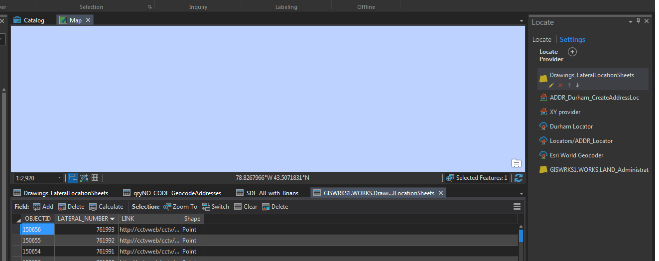

Hi,
I'm trying to use the 'Locate' to find attributes in a feature class.  I've used the Locate before, and have all the setting set properly.  It just isn't working anymore.
It's clearly in my attribute table:
And I have the Locate settings set properly:

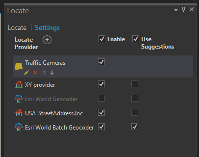

In addition to what Jake mentions above also make sure that the find provider is enabled in the settings of the Locate Pane.

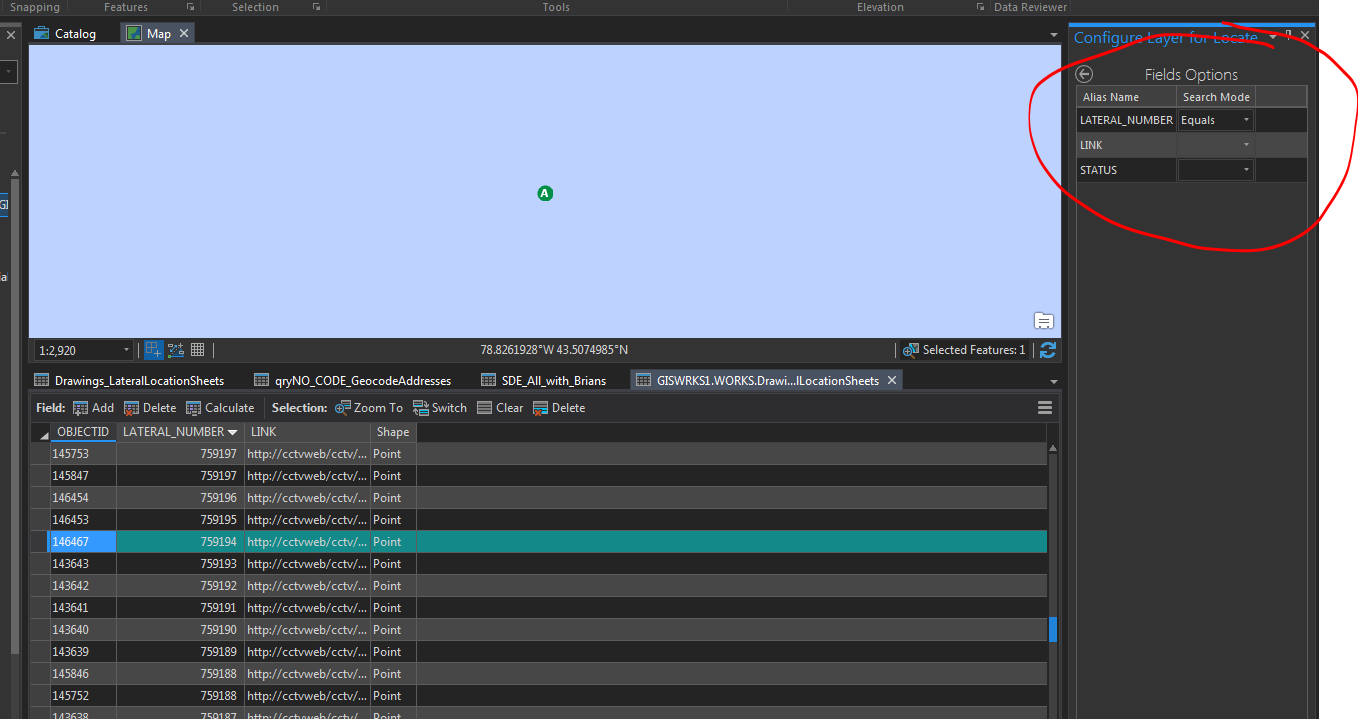

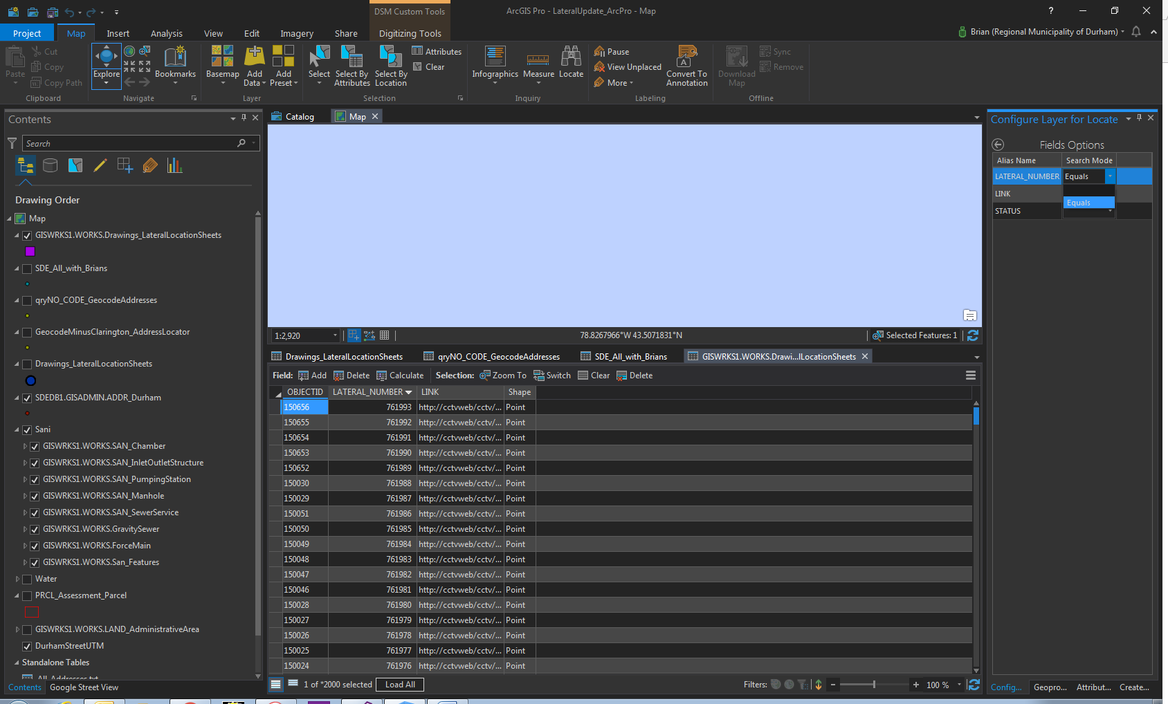

  2. I only have the option of 'Equals' (see image below)
  3. How do I build an index??  This is a layer that sits on SDE.  I am not an admin of SDE...just an end-user.  This is a large table.  If I open the attribute table it will find records close to the top of what is displayed, but if I scroll down far enough to where it displays "Scanning", it won't find any of those records.
And to Brad:  yes, the layer is enabled in the Locate pane.

What version of Pro are you using?  At 2.1.2 you have both Equals and Contains as options for searching.
BrianBulla
Honored Contributor
I am at 2.1.2.  It is a numeric field, so that is probably why Contains is not listed.  String fields have it.

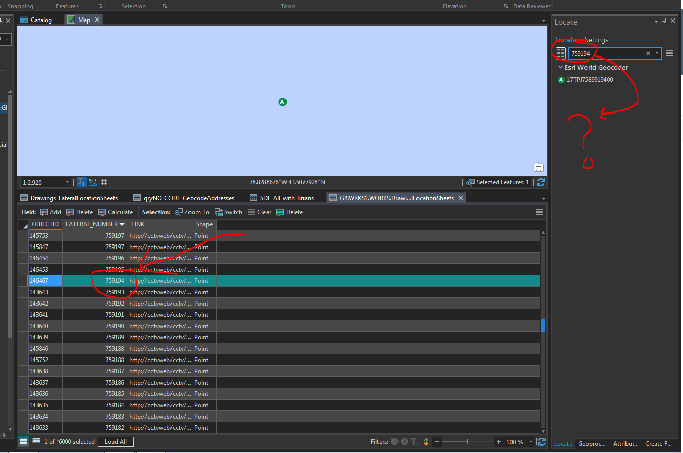

Hi Jake Skinner‌,
The Index was put on the feature class but the Locate is still not finding features.  If I scroll down the attribute table till it says 'Scanning', then do a 'Locate' for the indexed attribute, the value is still not found.
Any other ideas??
