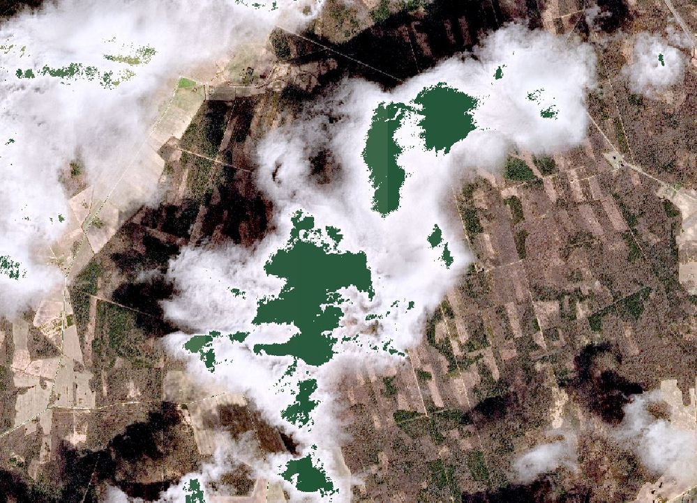

In this picture I opened the root file via a folder connection and the underlying layer is not showing in the RGB 255,255,255 pixels

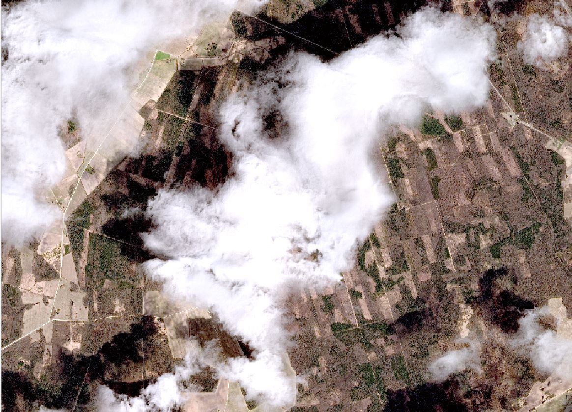

Here I opened the WMS published layer in ArcGIS Pro and in some of the white pixels the underlying layer is showing up

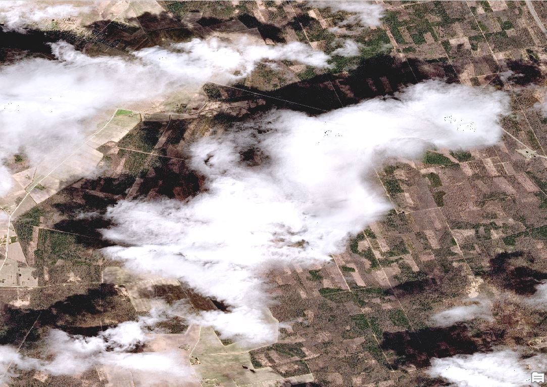

WMS_QGIS.JPG In this picture I opened the WMS in QGIS and in more white (RGB 255,255,255) pixels the underlying layer is showing.

SrinivasVinnakota
Open the layer properties in ArcGIS Pro (or QGIS) and make sure layer does not set a background color or make background color transparent. In ArcGIS Pro you will find this setting on the Display page of WMS layer properties.
