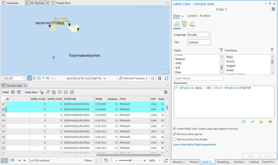

KenBuja
MVP Esteemed Contributor
No, this shows the results of the one-line code. The two highlighted points show the Data field above and below 40

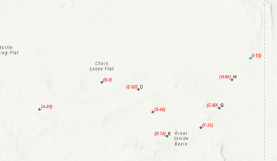

AlfredBaldenweck
MVP Regular Contributor
if ($feature.C2 > 40){
    var lab = $feature.C1
} else {
    var lab = Null
return lab
The points are labelled with both C1 and C2 in red, and then this expression is for the black text.
Ed_
by MVP Regular Contributor
Hi @AlfredBaldenweck thank you for quick response, so in your code lab =  C1 then how come both C1 and C2 are being returned on the map?
Question | Analyze | Visualize
AlfredBaldenweck
That's in a different label class for demonstration. The black text is what's being returned by this expression.
