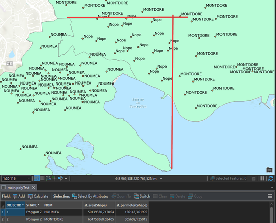

Here you can view in action :
There are no overlapping polygons, and the intersecting polygon has a value in the field, but for some reason, sometimes the function finds an intersecting polygon, but just doesn't return anything...
CEO of MAGIS
PierreloupDucroix
MVP Regular Contributor
Hello,
I made more tests, and now I am pretty sure that the issue is with the bounding box of the first polygon in the layer.
You can see in the previous image, that every point feature located in the second polygon, but intersecting the bounding box of the first polygon does not return the value.
If someone has encountered this or has a workaround...
So far I tried to delete/create spatial index, to copy features in another feature class, to recalculate spatial extent... Only the deletion of the first polygon resolve the issue... But of course I don't want that
[EDIT] I reproduced the bug in a simplified version :
I will contact the support team to log a bug
