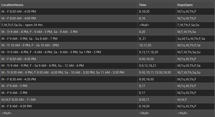

The null field shouldn't be a problem, but those other values for Time are confusing. What does something like "9:30, 10, 11, 15:30, 18:30"  or "9, 8, 19, 21" represent?
JaredPilbeam2
MVP Alum
Here's the bigger picture. The locations rarely have simple hours. It changes on certain days and on weekends. My logic along the way was to put the starting and end times for each day into the Time field.
Edit: I'm more or less experimenting on a working dataset. The LocationHours field is being used in the pop-up currently.

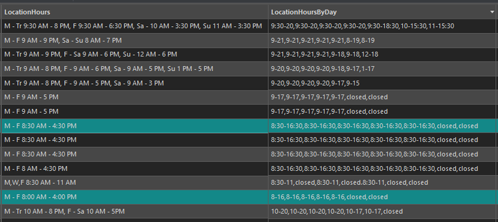

I found it almost impossible to figure out how to extract the days and times logically in an Arcade script. The only thing I could come up with it to have a string field (LocationHoursByDay) with each day's time span or closed in a concatenated list, where "M - Tr 9:30 AM - 8 PM, F 9:30 AM - 6:30 PM, Sa - 10 AM - 3:30 PM, Su 11 AM - 3:30 PM"
would be represented as "9:30-20, 9:30-20, 9:30-20, 9:30-20, 9:30-18:30, 10-15:30, 11-15:30"
while the line "M,W,F 8:30 AM - 11 AM"
would be "8:30-11, closed, 8:30-11, closed, 8:30-11, closed, closed"
That field would be utilized in this script

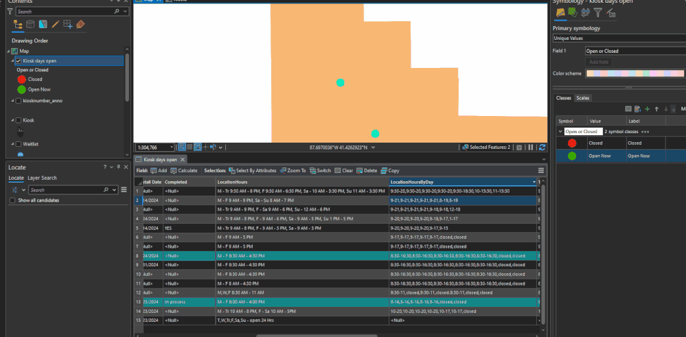

Thanks for the code. Unless I'm doing something wrong, I'm only seeing two Closed symbols created (highlighted in table below). And what's odd is that when when you zoom in Closed symbols for all features appear. There are no Open Now symbols created.
On what's your line 10 I used this variable:
var fTime = $feature.LocationHoursByDay
I created a text field called LocationHoursByDay.

I used a testing layer to try this out and it does show different symbols. I put that same code in the Label expression for more testing.
JaredPilbeam2
MVP Alum
I see what I did wrong. You have a space after the comma in the string here. In my table I didn't have spaces. I removed it in the script and it worked! Thanks a lot.
var times = Split(fTime, ',')
But I'm still getting weird behavior with what appears to be scale. Most features aren't visible until I zoom in. And I do not have the layer set with zoom in/out values. I'll have to investigate.
