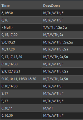

JaredPilbeam2
MVP Alum
@KenBuja
Thanks for pointing that out. It's a text field. Same goes for the DaysOpen field.
KenBuja
MVP Esteemed Contributor
And what types of values would it contain?
JaredPilbeam2
MVP Alum
The values would be opening and closing times. For example:
8, 4:30

JaredPilbeam2
MVP Alum
Thanks for that. I replaced the dummy variables and it verified OK. However, there was only the Closed symbol class showing. It's not returning Open Now. So, it's hard telling where it's going wrong.
  var DaysOpen = "Su,M,Tu,W,Th,F,Sa";
  var fTime = "8,8:30,9,9:30,10,10:30,11,11:30,12,12:30,1,1:30,2:30,3,3:30,4,4:30,5,5:30,6,6:30,7,7:30,8,8:30,9";
Unfortunately, there are more that a few Time field values that are after 6pm.

What are the earliest and latest times?
JaredPilbeam2
MVP Alum
Ah, yes. Thank you. Earlier I changed the values to 24hr times. The earliest is 8:00 and the latest is 21:00. There's also one oddball open 24hr location, which I'll have to work in somehow.
