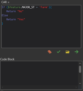

How can I write this Code Block as an Arcade expression

You are missing a couple of curly brackets. Each return statement needs to be enclosed by curly brackets. Also, you need to use a double equals sign when checking if something is equal to a value. A single equals sign is used for assigning variables.
if($feature.MAJOR_ST == 'Farm'){
   return "No"
} else {
   return "Yes"
 Refer to If - else | ArcGIS Arcade | ArcGIS Developers for info on if-else syntax.
Refer to Operators | ArcGIS Arcade | ArcGIS Developers for operators, which discusses = vs ==.
For straight forward if-else statements, arcade also has an IIF function, which can be a little easier to create:
IIF($feature.MAJOR_ST == "Farm", "No", "Yes")
Logical functions | ArcGIS Arcade | ArcGIS Developers

Hi,
I tried  looking for a solution in the link you provided but wasn't successful. What I am trying to do is write a simple Arcade expression to find all streets in my map with a Street type of Farm and return a value of "No" but if Street type is not = to Farm then return a value of "Yes".
This is all I can come up with but it doesn't verify
Can you help me with this?
   return "No"
} else {
   return "Yes"

That worked!
Thank you so much!
