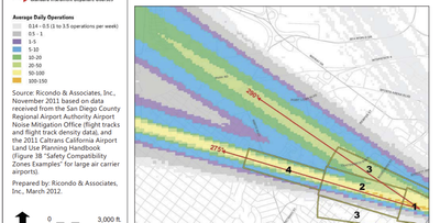

I have 17,000 operations and I want to graphically depict the density of operations/day, similar to the clip below:
