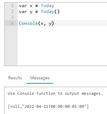

You're setting "TodaysDate" to the function "Today", as opposed to its output.
Similarly, in your PUTWSL variable, you're using the function itself as a parameter.
Easy enough of a fix, just put "()" after "Today".

Thank you so much!  That fixed it. Really appreciate the help!
