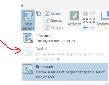

Any thoughts on why or how to un-grey a greyed out Spatial Map Series button?

Hi! The spatial map series option will be greyed out if there is not a map frame with a feature that could act as the index feature. So if your map only has a raster dataset, that can't be the index feature so the option is disabled. If there is no valid map and index feature you can't set up the spatial map series properties.
